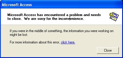

Access Report Crashes Database on Open
I have a fairly large report that serves as a production report for several employees.  There is a faily complex query that runs it.  This query links together 4 queries and brings in one table.  The query runs just fine, but when I try to run the report, access crashes and gives an unexpected error message.
The report worked fine yesterday and this morning.  I added two fields to one of the subqueries and imported them into the query that serves as the report's recordsource.  After that, the report crashes every time.

Avatar of Sean Strickland
Error Information (Error Signature):
AppName: msaccess.exe       AppVer: 8.0.0.5903       ModName: msjet35.dll
ModVer: 3.51.2026.0       Offset: 0002603d
Screenshot of error attached.
As strange as this sounds, earlier I reverted the changes made to 3 of the subqueries, and changed the report back the way I had it this morning (I can still open it in design view).  I left the items on the report recordsource query (they were listed as Expr1, Expr2, etc).
When I removed them, the report fired off correctly.
Thanks, I ended up finding that the solution was just a small oversight on my part coupled with joining tables incorrectly in one location.  The long load time for some of the reports and the crashing was due to access pulling too many records in the query because the joins were not working correctly.
