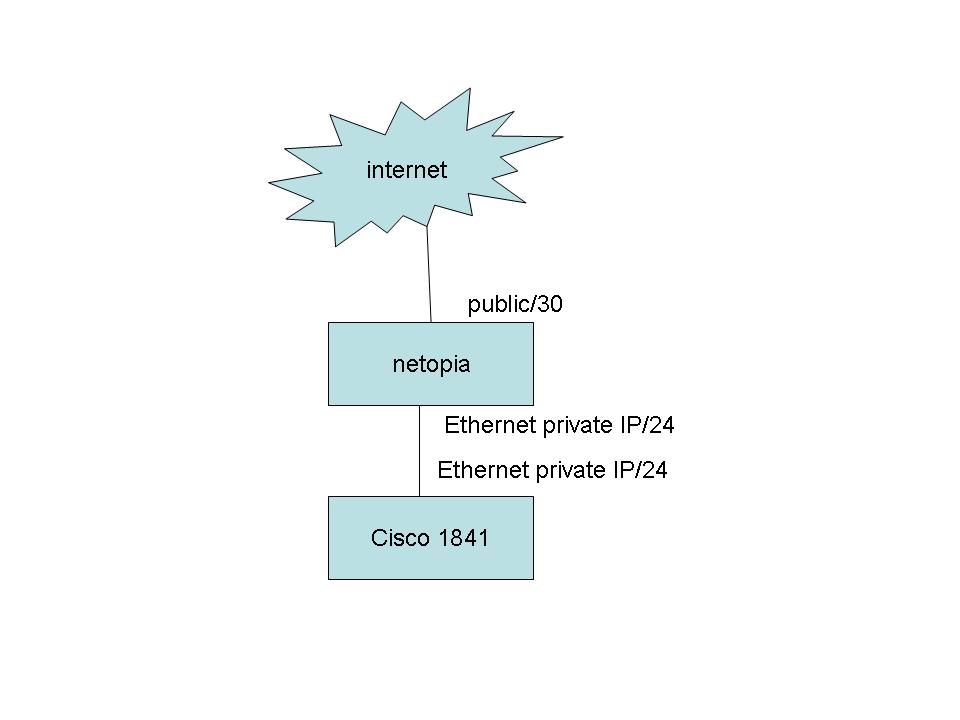

Let's make things clear now! Do you have 2 public addresses available in your /30 network or not? Often the addressing is as ck459 stated, the second address is used for the provider site of the router. If this it the case, you HAVE ONE ADDRESS.
In any case, you CAN'T use any public IP on the Cisco side. After DSL router, all addresses are local. For public addresses you would need either an additional subnet, or expand the available. Both is senseless.

Yes I have 2 addresses available on the /30 subnet. One of them will be hard coded on the outside of the netopia. So although I have another address in that subnet available to me I cannot put it on the ethernet of the 1841 or can I? I attach a simple jpg

No, you can't "publish" the free public ip to Cisco. You would need routing, and therefor at least 2 ip addreses only for this. However, there is absolutely no need to do so. Cisco can handle NAT-T with VPN, so NAT public to private adress is the thing to do.
