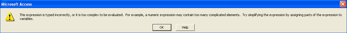

I'd like to be able to pass a control to a function from a JET Query.
SELECT CustomerID, CustomerName, GetControlName(Forms!Form1!txtBox) FROM tblCustomer;
For my trouble I was greeted with...
     The expression is typed incorrectly, or is to complex to be evaluated...
The objective here has nothing to do with getting a controls name so please, no posts suggesting...

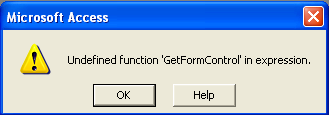

GetFormControl() is just another failed attempt to get around this.
    SELECT CustomerID, CustomerName, GetControlName(GetFormControl("Form1","txtBox")) FROM tblCustomer;
Expecting to get the same error, JET greeted me with... "Undefined Function" as if it was now unaware that the function even existed.  Sample() was just a test from VBA to insure that the code did in fact work from there.
Any ideas?

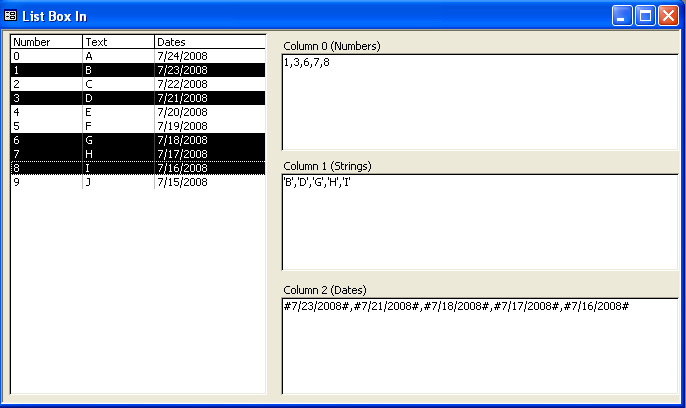

So, for example the idea is to return a string of say ID's to be used for example in an IN clause
IN (3,7,22,77,102 .....)
So ... from the query, you need to pass exactly what?  The name of the form and the list box the form is on?  And then the function grabs the selected ID's in the list box, and concatenates a string and returns that to be used in an IN clause ... for example ?
mx
Avatar of Rick_Rickards
Rick_Rickards

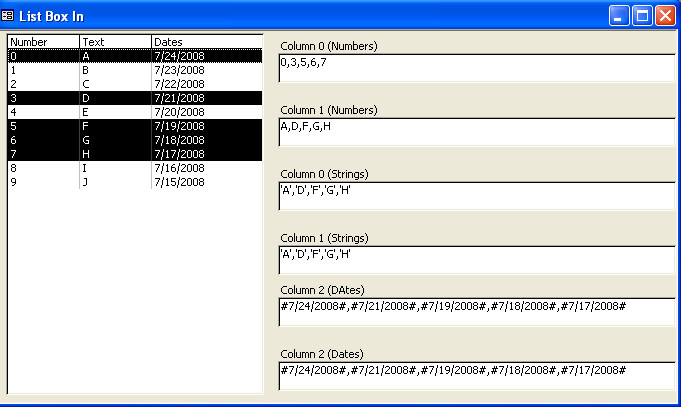

Attached you'll find the sample application reposted with a query in it named "qrySample"  The SQL is posted below.
The object reference would come from a form already open.  It could be on the other hand a list box on the same form that's query looks something like the one you see below, allowing the query to be updated to only items selected without having to do anything more than requery the list box.
How many times have we seen people want to have a list of items a person can select and then have another list box that includes only the items that were selected.  Now the 2nd list box wouldn't need any change to the query, a simple requery would do but then that only works if JET will receive an object as a parameter being passed to a function.
SELECT tblX10.X10
FROM tblX10
WHERE (tblX10.X10) In (ListBoxIn([Forms]![frmListBox]![List1]));

One last recap.  One fix and then general cleanup of the sample app attached.
SELECT [tblX10].[X10]
FROM tblX10
WHERE ([tblX10].[X10]) In (ListBoxIn([Forms]![frmListBox]![lstBox]));
ListBoxSample.mdb

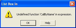

Rick_Rickards
CallByName() is a nice theory, unfortunately it didn't work either.  If it would work I'd expect the syntax to be something like the code snippet below.
From VBA CallByName does return the object just as it should from which you can act on it as if you'd set your object variable normally or passed it as such.  From JET, same problem, it just doesn't like it.  I can't help but think the fact we have two totally different errors is telling us something but what?
SELECT tblX10.X10
FROM tblX10
WHERE ((tblX10.X10) In (ListBoxIn(CallByName([Forms]![frmListBox],"lstBox",2))));

Function ListBoxIn(R, i, c, k, ²): On Error Resume Next: ListBoxIn = ListBoxIn(R, i, c, k, (² - 1)) & IIf(² - 1, c, "") & k & R.Column(i, R.ItemsSelected(² - 1)) & k: End Function
Rick_Rickards
Special thanks to harfang for an excellent answer to the question!!!  Equally appreciate MX's tenacious efforts to find the solution!!!   Great Job Everyone!!!
