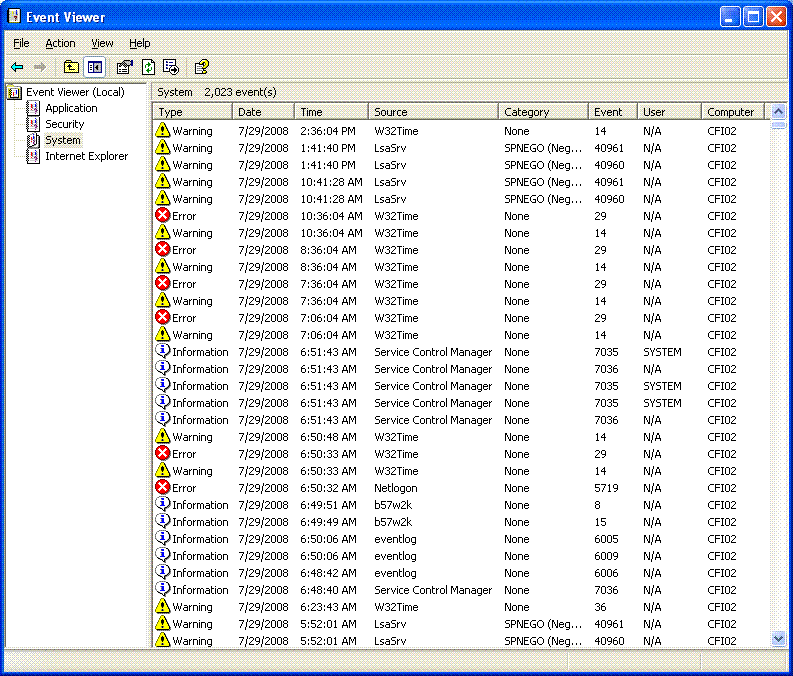

I have attached a screen shot of my current Event Viewer with today's Events.

O.K there are no events in the event log that occurred during the same time period as your problem.
You may want to look at the other logs and see if they have any.  You may also want to look at the server's events logs to see if it is showing anything.  If the application has its own logs, you should check it out.

- -- - - - - - - start clip
C:\>net time
Current time at \\CFSERVER01 is 8/4/2008 11:37 AM
The command completed successfully.
C:\>net time /querysntp
The current SNTP value is: time.windows.com,0x1
- - - - - - - - - end clip

Ok... I had to reboot at 3:15pm today - same problem as before.
However, 15 minutes after rebooting, I looked at the Event Viewer --> Event ID 35: "The time service is now synchronizing the system time with the time source CFSERVER01.customforms.com (ntp.d|172.30.1.248:123->172.30.1.5:123)."  I notice my PC clock is < 1 sec of "atomic time".
I don't know if this is a positive sign... I'll wait until later tonight or in the morning to see what's going on and then probably do the "net time" commands on my client PC - I think I'll need to logon as an admin in order to be able to do these commands.

Avatar of rlahrlah
Trouble...
My Event Viewer is showing more problems this afternoon after I rebooted:
1) 1:35:56 PM, Warning: W32Time, Event ID: 14: "The time provider NtpClient was unable to find a domain controller to use as a time source. NtpClient will try again in 120 minutes."
2) 1:35:56 PM, Error: W32Time, Event ID: 29; "The time provider NtpClient is configured to acquire time from one or more time sources, however none of the sources are currently accessible.  No attempt to contact a source will be made for 239 minutes. NtpClient has no source of accurate time. "
Something is not working.
giltjr: Maybe I should do your suggested command on the server (ID 22249099):
net time /setsntp:x.x.x.x
where x.x.x.x is either the IP address or host name of the sntp server you wish to sync your time with.
ChiefIT: the utility to check time synchronization on the server showed my PC with something like 140 milliseconds difference... rather close.  So my PC appears to be in time sync.
Although my computer's network drives are still functional, I doubt they will last.  Why these Event messages?

Avatar of rlahrlah
More trouble... in the AM.
My PC needed to be rebooted, then I couldn't logon even as Administrator.  OK, go to the server... hmmm the AD is giving the following error message:
"Naming information cannot be located for the following reason: The server is not operational."
Ouch.  OK, reboot the server.  Everything went OK on the reboot and the AD is now operational again.  But this is the first time in over 4 years this has happened on the server.

Avatar of rlahrlah
giltjr:
My IT consultant found my client wasn't going to the server for the DNS thing but to an outside address, actually our ISP's address.  It is a mystery how it could be working except that there is some ghost DNS server inside here.  He set my client to force it to go to our server's IP address and now my client seems to be running  better.  It booted up much faster than before.  I'll know more after 8-10 hours from now.
So I think giltjr was right in his judgment that there was an "intermittent networking issue".  I'll report more results within a day.
Avatar of rlahrlah
So far my client PC is running *much* better after the visit from my IT consultant.  Although it appears my main problem was an inexplicably errant IP address for the DNS (to outside ISP instead of to our inside server) instead of a time synchronization issue, yet I think the time sync process was useful for the long run.  I have it running and, now that my network connection is healthy, it appears to be synchronized quite well.
