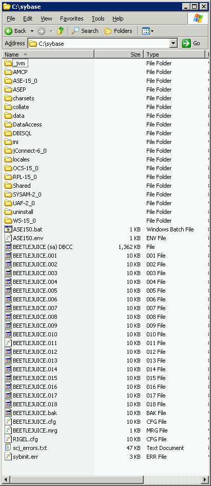

Do you actually have a c:\sybase ? What's in it?

Yes I actually have a c:\sybase (see attached file)
It was working, then I stopped the service after sybase central hung and I couldn't get back in. Now it won't start back up.
locales.dat isn't present.

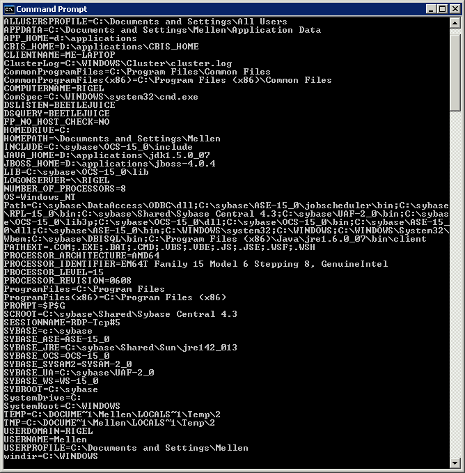

What are the current values of your Sybase environment variables? Open a CMD prompt and run "set" and post the output, please.

Avatar of Joe WoodhouseJoe Woodhouse
