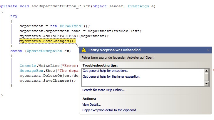

not same error message as already stated before:
A first chance exception of type 'System.Data.EntityException' occurred in System.Data.Entity.dll
no its not going into the catch block its not even saving ANY data, very weird... ??
[URL=http://imageshack.us][IMG]http://img227.imageshack.us/img227/6802/testly6.gif[/IMG][/URL]

Did it enter the catch at all?
Avatar of LisaTatum
LisaTatum
as you can see from my attached window it stopped at the SaveChanges() method.
Avatar of Fernando Soto
Fernando Soto
Try placing a catch all exception block as the last catch block in the try/catch structure. Then read the stack trace and see what type of exception was thrown then create a catch block for that type of exception.
// The catch all Block
catch
    Console.WriteLine("Error: " + ex.StackTrace);
    MessageBox.Show("The department: " + departmentName + " already exists", "Error!", MessageBoxButtons.OK, MessageBoxIcon.Exclamation);
    mycontext.DeleteObject(department);
    mycontext.SaveChanges();
