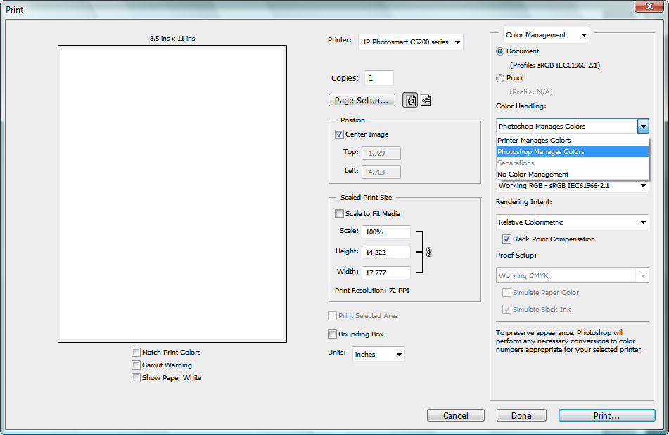

I think the feature you are talking about is Photoshop's feature and not the feature of the printer software/driver. Check the attached screen shot. Its photoshop's print dialog box and you can see the Color Management options on the right. I am using Adobe Photoshop CS4, but I believe these options were there in CS3 too.

Thank you for your response!  I do have the settings in the picture you attached, and I am able to select them.  The problem is that I can't disable the color management in the printer and let Photoshop take over.  So, when I click 'let photoshop manage colors' the color management is still on in the printer, which is essentially pointless...I will put a screen shot up in a bit to illustrate what I am talking about.

Anindya,
Thank you for your help!  I didn't put up a screen shot because I have come to the same conclusion--I am pretty sure that the C & D series printers do not have this option.  I checked on a friend's C4000 (can't remember the exact numbers) and it didn't have that option either.  It's odd though because my old HP 7800 (from 2004 or something) has it...I guess I'll just have to deal with it!  Re: sending the screenshot to HP--(I had to add this because it's quite humorous to me)--they actually took over my computer remotely and still didn't get what I was asking!  I had to show her a website that illustrated what I meant before she even understood that I wasn't trying to print in B&W.  Honestly, it was one of the worst customer service experiences ever!  Thanks for your help--it is much appreciated!
