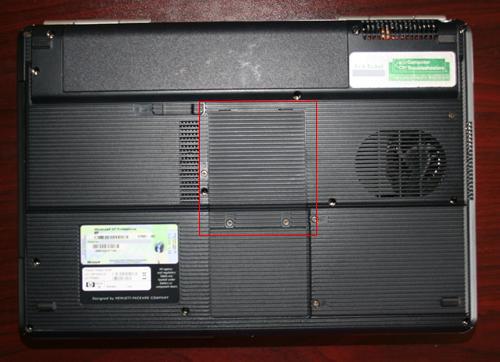

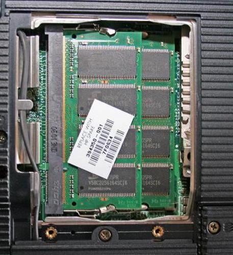

Avatar of AliokasAliokas🇮🇪
Reseat ram modules, or remove one module, then swap modules - to determine which one is  faulty (if faulty.
ok
Aliokas,
I Reseat ram modules,  remove one module, then swapped modules. No Luck. Whats this mess I keep reading in blogs about saudering the mother board?
