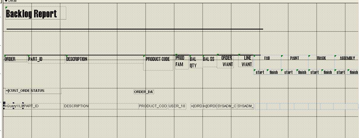

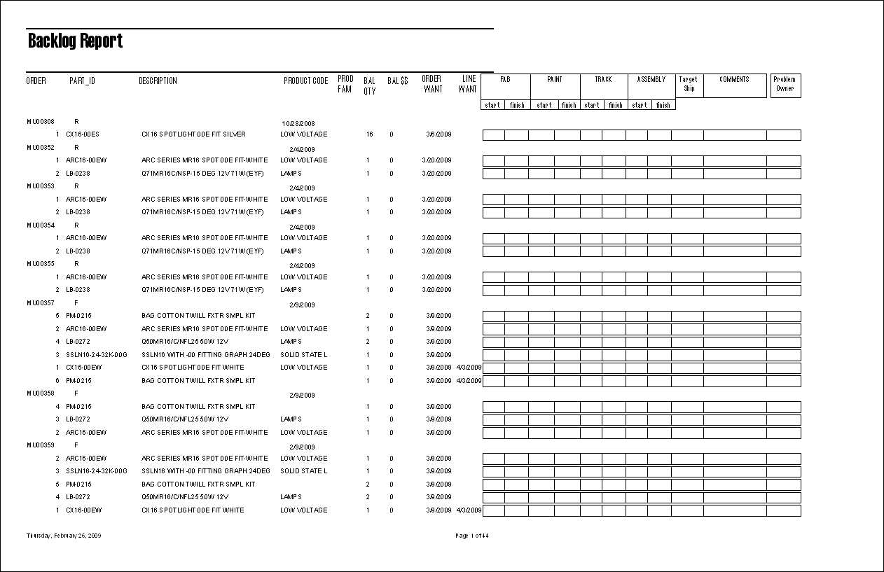

I have a report that 1/2 of the data is pulled from oracle 8i via ODBC. I can do that :-), the next step is the problem, i have built a table with fields just like the attached screen shot. What we would like is a form or report where we can manually add the start finish times and other text, and have it save this data in a dynamic table linked by order number and part_ID to look just like the screen shot so all the boxes on the right will be dynamic. TIA  Bill

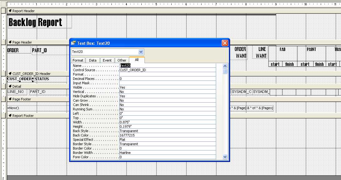

OK i copied over the report fields, they seem all broke. I think i need to somehow group by Work_Order_ID as on the report. How do i do this in Form? I have attached a screen shot looking at both the form and report field property sheet. Let me know if you would  like to see any further info to better help my sorry butt. TIA Bill

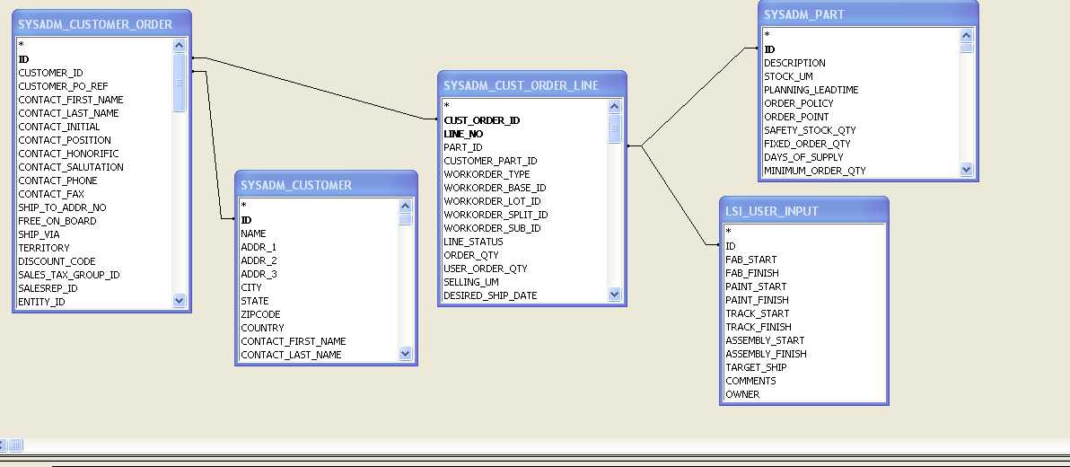

Yes it is, see attached a screen shot of the linking structure, LSI user input table is the table i made with fields for user input.

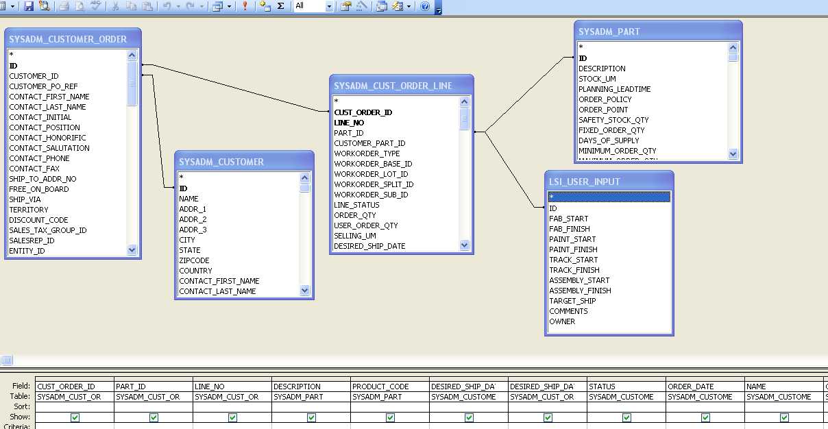

Ahh yes, i have already done this, i think it works. i attached the SQL. I don't know how to get the form to layout like the report, allowing the correct fields to be dynamic. I also attached a screen shot with linked table LSI_User_Input, this is the table with the fields that i want to be able to dynamically update.
