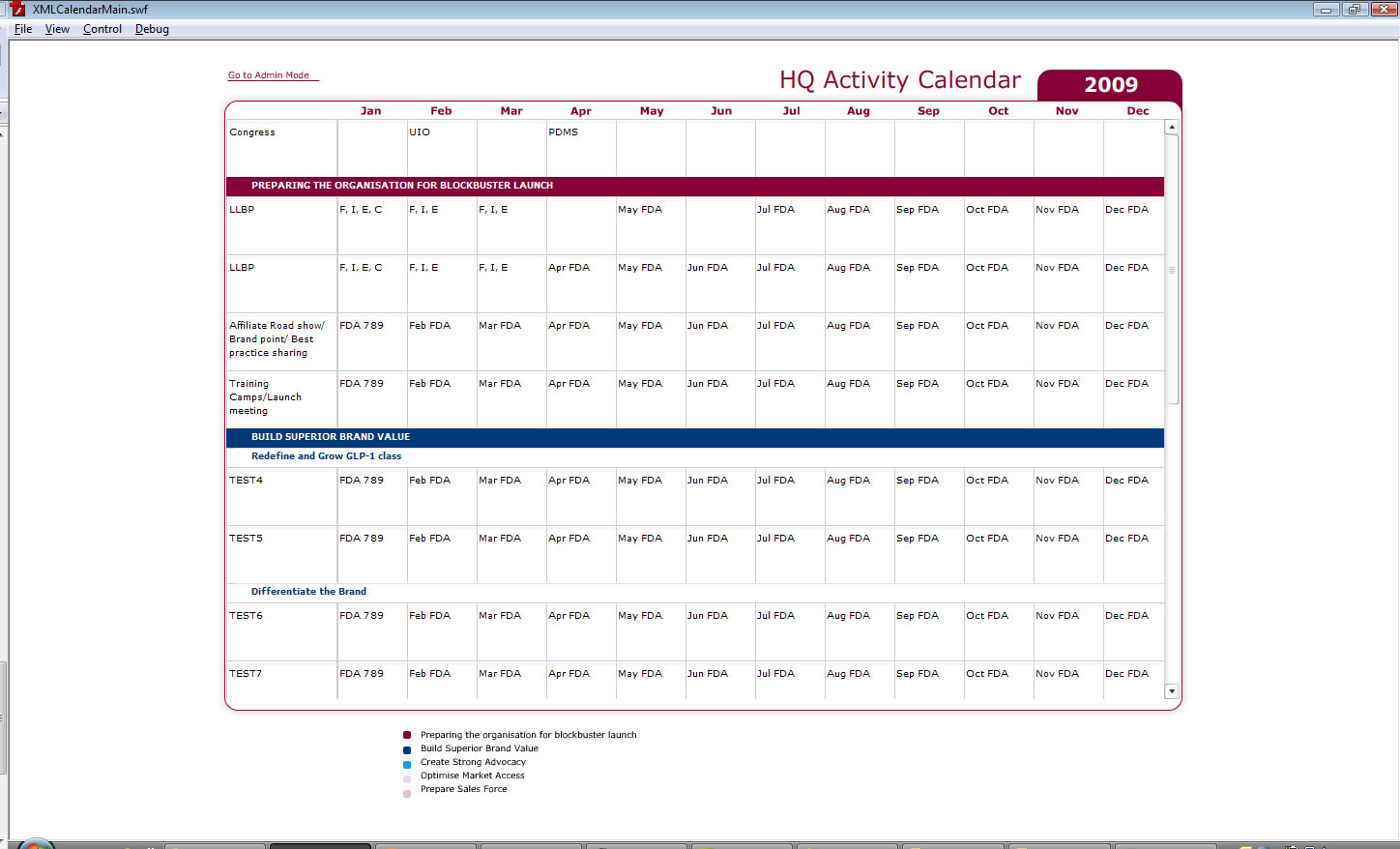

I loop through XML and create squares using the duplicate movieclip function.-> dynamically.
Just on the correct reference paths, I am little new to actionscript, and I must tell you I find it very daunting to keep track of the layers, levels and references. :)
I have a dynamic textbox that has a variable that I pass values to (txtheading, variable varheading), and this I can reference easy >>>."...eventToSearch=this._parent.varheading; .."
My problem is that I do not know(Yet), how to create a variable/object on that Square movie clip that can store the values for me..so that when i click on the movieclip (square) it retrieves that unique value stored. In my case I want to stores values;
1) Event Category
2) Event Name
3) Event Month
in a single square . so that when i click on that square i can use those values to lookup data in the XML file (As per your previous function you submitted).
I have attached the code that creates the calendar based on my XML.
Regards
Mackie

			for (ie=0; ie<events.length; ie++){
				setWidth =115;
				var eventName =  events[ie].attributes.name;
				//trace("events name :"+eventName);
				catTextFormat.size = 10;
				catTextFormat.color = 0x000000;
				catTextFormat.bold = false;
				duplicateMovieClip(square, "csquare"+counter, counter);
				setProperty("csquare"+counter, _x, 0);
				setProperty("csquare"+counter, _y, (Number(getProperty("csquare"+(counter-1), _y))+Number(getProperty("csquare"+(counter-1), _height))));
				setProperty("csquare"+counter, _height,setMonthsHeight);
			 	setProperty("csquare"+counter, _width,setWidth);
				//if(eventName=="none"){
				//_level0.ScrollPane1.spContentHolder["csquare"+counter].varheading = " ";
				//else
					_level0.ScrollPane1.spContentHolder["csquare"+counter].varheading = eventName;
				_level0.ScrollPane1.spContentHolder["csquare"+counter].txtheading.setTextFormat(catTextFormat);
				_level0.ScrollPane1.spContentHolder["csquare"+counter].txtheading._x=0;
				//colCat = new Color(_level0.ScrollPane1.spContentHolder["csquare"+counter].sqbkg_mc);
				//colCat.setRGB(0xFFFFFF);
				//colSquare = new Color(_level0.ScrollPane1.spContentHolder["csquare"+counter].catcolor_mc);
				//colSquare.setRGB(0xFFFFFF);
				counter = counter+1;
				//currentrow = currentrow+1;
			//===============Loop through the MONTHS for the EVENTS for the Categories=================================
				var months:Array = events[ie].childNodes[0].childNodes;//get the main <months> nodes in a array
				var startX=0;
				currentmonth = 1;
				startX=115;
				var month =  events[ie].childNodes[0];
				for (im=0; im<months.length; im++) {//iterate through each <month> node
				setWidth =72;
				var evententry = months[im].childNodes[0].firstChild.nodeValue;
				//trace("Entry:"+evententry);
				setProperty("csquare"+counter, _x, (startX));
				setProperty("csquare"+counter, _y, Number(getProperty("csquare"+(counter-1), _y)));
				if(evententry=="none"){
					catTextFormat.color = 0xFFFFFF;
				else
				 _level0.ScrollPane1.spContentHolder["csquare"+counter].varheading = evententry;
				startX = startX + Number(getProperty("csquare"+counter, _width)+setSpacerX);
				currentmonth = currentmonth+1;
xml.load("XML/BuildCalendar.xml");
//trace(_global.selCat);
stop();

Thanks for the quick reply..
Please forgive me for being so backwards.. in your code sample...
var obj:Object = new Object();
obj.category = catname;
obj.subcategory = "none";
obj.eventname="eventname1";
obj.monthvalue="Jan";
//copy created object to duplicated movieclip
             dupmc=this["csquare"+counter];
             dupmc.my_data=new Object();
             var ii;
              for(ii in obj){
             dupmc.my_data[ii]=obj[ii];
I am not sure what dupmc represents? Is dupmc a new movieclip that I need to reference?
I think I understand what you are doing, just that in my square movieclip.....
when i run for(i in this.my_data){
    trace(i+"="+this.my_data[i]);
 gives me an undefined...
 I get undefined.. I can however access teh "variables on the movicelip" as this_parent.variable names...
if I do a trace(this._parent) >>>
I get  _level0.ScrollPane1.spContentHolder.csquare47 (wgich is the level that I need to acces my "data".
i can not access dupmc. ?
Can you clarify.
Thanks again in advance..
