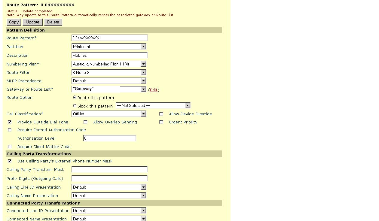

I have attached one of my newly created route patterns for mobiles but calls to mobiles are still taking ~10 seconds (the set interdigit timeout value) rather than matching the route pattern and automatically passing the call to the gateway. Is there any reason why this might be?

One more thing... if you have multiple patterns that begin the same way, you will still have this problem with the shorter of the two patterns.
For Example:
0.04XXXXXXX
0.04XXXXXXXX
This won't work for the first pattern because it is technically a match to both of these.  As a result, the system will wait 10 seconds to see if you enter another digit to match the second pattern.  The only way to get around this is to establish unique patterns.
For Example:
0.041XXXX
0.042XXXXXX
Hope that helps.

This was described perfectly. Now I just have to go away and plan my dial peers. Thanks
