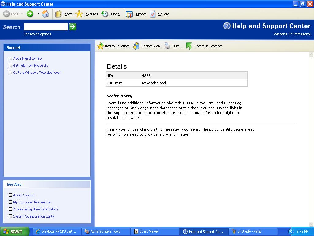

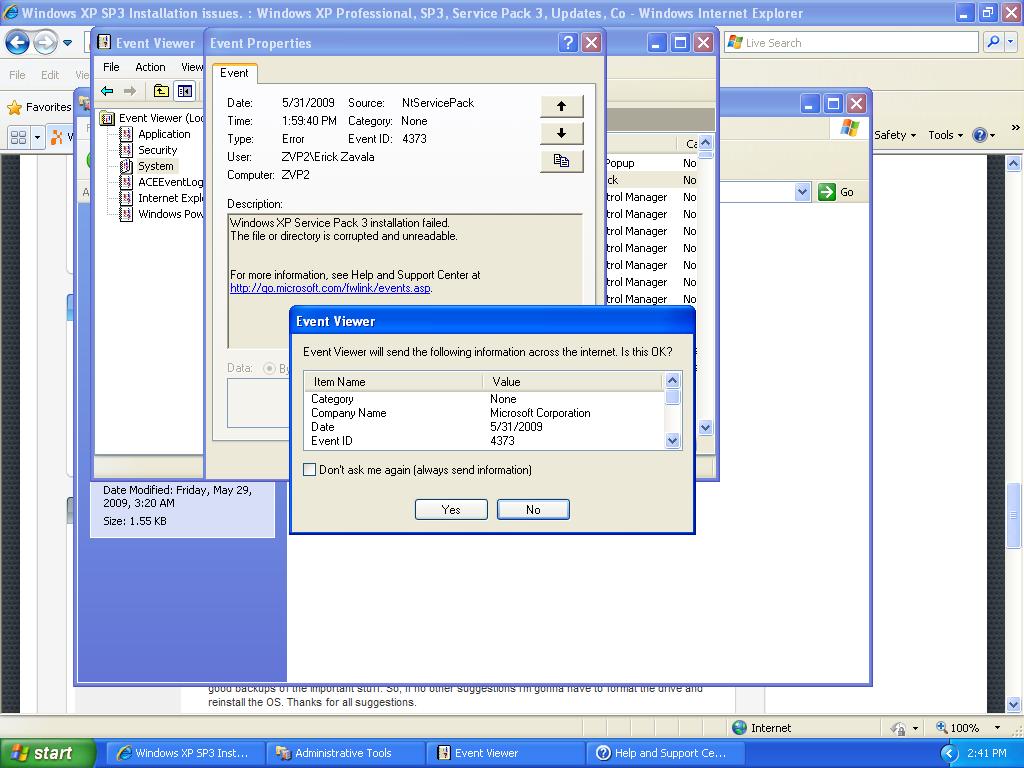

Avatar of erickzavalaerickzavala🇺🇸
You guys may have missunderstood the question, maybe i didn't express it correctly. After carrefully trying all your suggestions I'm still in the same situation. After watching the Service pack 3 installation process i have come to the conclusion that there is something wrong with the registry. Becuase the error happens when it is backing up the registry. that's when it gives me the error. Also i have cheked the event viewer as suggested and there isn't much information. I have attached a file with the information from the event viewer. I have run registry mechanic but didn't fix it either. I know the SP3 installation is not corrupt because i just installed the manual  version on another drive i'm configuring. I am trying not to have to reinstall the operating system because it is about a 24hour job installing all the programs back. I have good backups of the important stuff. So, if no other suggestions i'm gonna have to format the drive and reinstall the OS. Thanks for all suggestions.
Avatar of jcimarronjcimarron🇺🇸
erickzavala--You did not follow the procedure I posted for getting all the info out of Event Viewer.  You still have another one or two windows to see after you click the blue go.microsoft link.
jcimarron, you mean the following two windows?

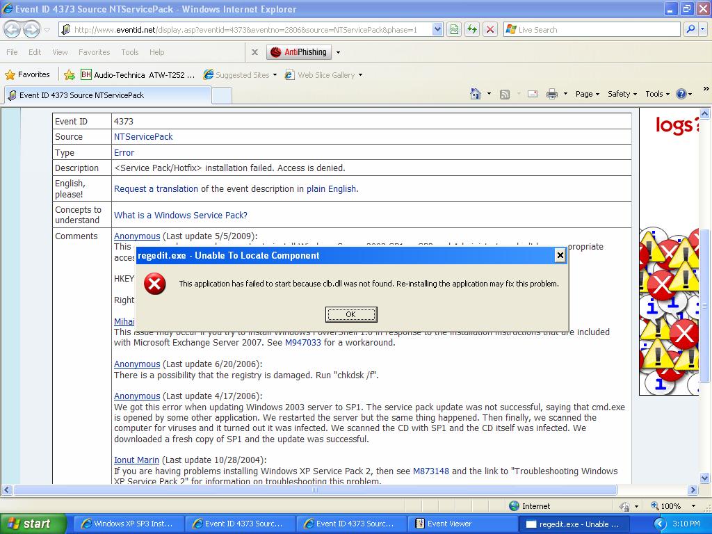

This happenes when i try to run rededit.exe.
erickzavala--We may be in a situation here where one fix leads to another problem. And at the end you have done a lot of work, the problems are not fixed (in fact they get worse) and you have to reformat.
Which of the links in my last post gave the error?
There are potential fixes for your latest problem,
http://www.annoyances.org/exec/forum/winxp/1054246526
https://www.experts-exchange.com/questions/22074144/This-application-has-failed-to-start-because-clb-dll-was-not-found.html
But maybe it would be wiser to try a System Restore to a date before ALL the Problems started.  However I am not sure you will have System Restore points after a Repair Install.
And you could scan your PC with your antivirus and antispyware programs (using latest reference defintion files).  Delete what is recommended.  And then you may want to
P.S.  It is regedit.exe,  not rededit.exe, but I see you must have typed it correctly based on the error window title.
I fiixed the regedit.exe problem just by copying the clb.dll from another harddrive that has Windows XP pro installed. But yeah, there maybe more .dll's files missing. and i don't think i'll be able to find every single one of them. so i'm just gonna have to do a fresh install of the OS. I hate that, this is the 4th time in one month that i had to do this on the same computer. Yeah, the system restore crossed my mind and i checked but  it didn't have any restore points before the repair install. Which backup software is pretty good to back-up a whole system?
