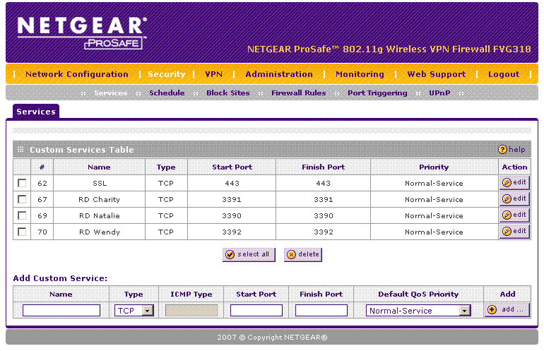

How can I get remote desktop to work with a Netgear Prosafe Firewall VPN router?
We recently replaced the router in the building. Since replacing it, the three users who logged into Remote Desktop from home cannot access it anymore.
I have setup three services in the firewall area of the router. These are configured for TCP and for the corresponding port that each PC is listening for RD connections on. Example, Ports 3389, 3390, and 3391.
I then created Inbound rules using each of these custom made services, made the action "Always Allow" and set the "Send to LAN server" option to the LAN IP of the client. I have enabled (and also tried disabling") the option to "Translate to port number" to the correct port each client is using but to no avail. It's not letting me connect at all. Any help?

Can you do a screen shot of the page where you configured the inbound rules for the RDP?. I have a feeling something got changed.

Can you print screen the Router configuration page. I wan to see how the ports are configured and how they are forwarded. that's where your problem is.
It has nothing to do with GPO, trust me.
Here are the services I setup for each RD client, then the Inbound Firewall Rule I created for each service (which routes it to the appropriate LAN IP)

Ok so from the 192.168.1.175 machine can you rdp to the 192.168.1.176 using 3391 port?
and then to 192.168.1.176 to port 3392 ? do they work?
Also I didn't see any port forwarding for 3389. how do you access your server from outside when you don't have 3389 in there. Is there a chance you made your server DMZ. If yes then that's your problem right there
