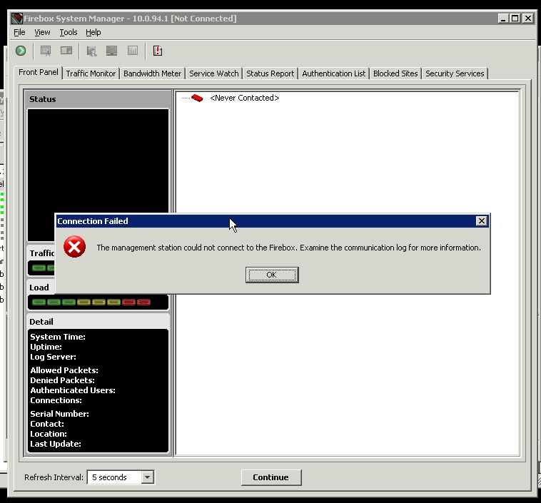

Unable to Connect to Firebox System Manager on x550e Firewall
I'm Unable to Connect to Firebox System Manager on a x550e Watch guard Firewall.
I've logged the call with Watch Guard but they seem unable to help me at this time.
The communication logs say:-
06/23/09 22:00:49      Initiating login of appliance.
06/23/09 22:00:50      Login of appliance successful.
06/23/09 22:00:50      Initiating handshake with appliance.
06/23/09 22:00:50      Handshake failed.
06/23/09 22:01:00      Initiating handshake with appliance.
06/23/09 22:01:01      Handshake failed.
Watch Guard suggested I reboot, take box back to factory default and run Quick Start Wizard again. No Luck. I don't think it's a hardware fault because I have three (3) boxes purchased different times with the same problem. It's got to be something I'm missing.
I'm using WSM 10.2.9 and Fireware 10.2.9.
Please help me someone, please.

Please look at the attached picture. I can get into the firewall, add or modify policies all that stuff. I tried the cross over cable that didn't work.
It's the firebox system manager I'm tring to access. I need to look at the traffic monitor, bandwidth meter, service monitor, etc.

I already reset the firewall to factory default and re-ran the QSW but no luck. Please see new image.
Avatar of dpk_waldpk_wal🇮🇳
It is http and not https, please try: http://10.0.94.1:8080/
As seen from image you are already connected to device using WSM; as I understand you are unable to open Firebox System Manager; though other things like Policy Manager, Host Watch open fine.

Thanks a mil after several factory resets and reloading my old config, I finally did a factory reset and created a new config from scratch and that did the trick. I noticed this when I tried to connect to the WSM right after a factory reset and it worked with the default config. I then restored an old config and the problem re-occurred.  Super so I can now do the same with the other boxes I'm having the same issues with.
