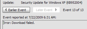

WSUS Error: Download Failed
Hello Experts,
I can't figure this out. I have a Windows 2003 R2 WSUS server that is reporting only 4 updates as being failed on every computer in my domain. All other updates including new updates download and install without any problems. I don't know where to go from here. Has anyone encounter this problem and if so how to resolve? I've already uninstalled and reinstalled the WSUS server twice only to experience the same problem.

I tried several times to post the windowsupdate.log but was too big. Here is an excerpt of one of the Windows Updates that failing.
2009-05-04    08:06:57:205    1172    f04    AU      # WARNING: Download failed, error = 0x80244019
2009-05-04    08:07:00:156    1172     d8    DnldMgr    WARNING: BITS job {9C9F8968-661E-4ED5-908C-6A96C75B61D8} failed, updateId = {3C4A3A1F-E61E-4E87-9EC4-E77A4212A807}.102, hr = 0x80190194, BG_ERROR_CONTEXT = 5
2009-05-04    08:07:00:156    1172     d8    DnldMgr      Progress failure bytes total = 0, bytes transferred = 0
2009-05-04    08:07:00:156    1172     d8    DnldMgr      Failed job file: URL = http://bak/Content/80/28E11CE4E9083F84C7B9903716904A94DC6B7280.exe, local path = C:\WINDOWS\SoftwareDistribution\Download\83f2004544abb3aad898c7079ac172e1\WindowsXP-KB952004-x86-ENU.exe
2009-05-04    08:07:00:204    1172     d8    DnldMgr    Error 0x80244019 occurred while downloading update; notifying dependent calls.
2009-05-04    08:07:00:204    1172    f04    AU    >>##  RESUMED  ## AU: Download update [UpdateId = {0F4FB382-5878-48C5-B7A4-C70F8EB0D7C6}]
2009-05-04    08:07:00:204    1172    f04    AU      # WARNING: Download failed, error = 0x80244019
2009-05-04    08:07:02:362    1172    e30    Report    REPORT EVENT: {D68EC426-0A96-4895-B21B-F84E8552AF5A}    2009-05-04 08:06:57:332-1000    1    161    101    {9D729479-604C-4330-B0EC-EB204C0B80F3}    102    80244019    AutomaticUpdates    Failure    Content Download    Error: Download failed.
2009-05-04    08:07:02:362    1172    e30    Report    REPORT EVENT: {70A3F318-2CA8-46D2-BE65-06B682FD33D5}    2009-05-04 08:07:00:204-1000    1    161    101    {0F4FB382-5878-48C5-B7A4-C70F8EB0D7C6}    102    80244019    AutomaticUpdates    Failure    Content Download    Error: Download failed.

what is even more strange is that I manually installed KB952004 on one of my servers and in the event log it shows as being installed, but when I open WSUS Console, it is showing up as "Failed"
Event Type:    Information
Event Source:    NtServicePack
Event Category:    None
Event ID:    4377
Date:        7/23/2009
Time:        11:48:18 AM
User:        ATA\root
Computer:    BAK
Description:
Windows Server 2003 Hotfix KB952004 was installed.
For more information, see Help and Support Center at http://go.microsoft.com/fwlink/events.asp.

after manually installing the failed updates on the server above, it didn't update the WSUS server at first, but when I checked today, it no longer shows up on my failed update list. i guess it was a glitch in WSUS server or client (still don't know which one is the culprit) for these 4 updates.
