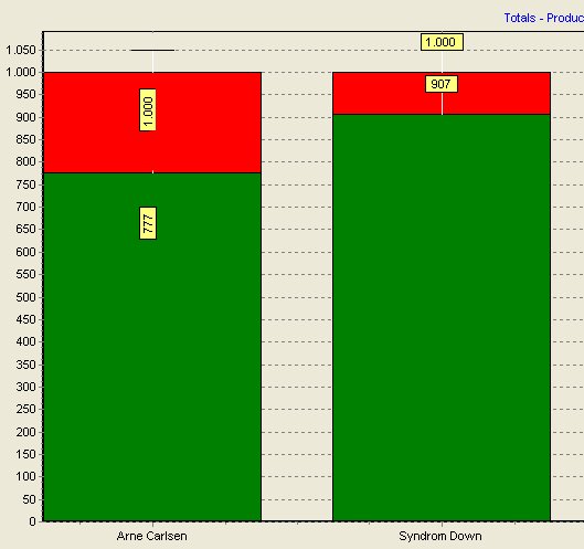

With this, one series Marks are not seen and the other is shown (as default) above the bar. I would like to change the placing of the marks text (bar label) so that the text is vertical and inside the bar (or at least inside as far as it fits - otherwise it has to stick out the top) - How do I manipulate, in code, where the text of the mark in the series is placed in the chart?

do you have a screenshot what you have now and what you want ?
Avatar of JustinThorJustinThor
Hello Geert,
Attached is a jpg showing on the right side (right bar) how it is default and I have (just quickly in Paintshop Pro) changed the placing of the Marks on the left Bar to roughly what I want. In this example it is just short numbers, but I will have text in the marks as well - meaning that the length will vary. Also the bars are large in this example. But what I want is to know how I can in code change the orientation and placing of the Marks relative to the Bars they are attached to. Thanks.

oops, i did find it:
set the angle of the text of the marks
and the length of the arrows to negative value
