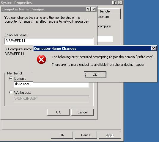

There are no more endpoints available from the endpoint mapper
When I join a server from workgroup to domain then the erroe screen is coming after the usrname and password authonitication.
Error is " there are no more endpoint available from the endpoint mapper"
Note: DNS query- Record A and PTR record resolved successfully on the server.
Port : 135, 139. 445, 389, 636, 88, 53 are open and telnet to DC successful.

I checked all the mentined link but No issue are there.
I found the error "NetpSetDnsHostNameAndSpn: NetpGetComputerObjectDn failed: 0x6d9" in the %systemroot%\debug\Netsetup.Log file so pls assit me accordingly.
For your more reference I am attaching the whole error.

All the required ports are open (bi direction) between the source and destination. My other servers(same network) had added in the domain but only this computer is not add in the domain.
I mentioned the error in my previous comments so pls check and provide the solution according.
Find the attached error snapshot file.

Not happening from other server as well. There is a firewall between Domain and server which i wanted to add into domain. If possible please let me know the list of ports which i can request to firewall team and get those port open for adding server into domain.
Thanks !
After opening any port (from client to server) from firewall server is added to domain. I need to know what ports used between Domain and member server to add the server into specific domain.
