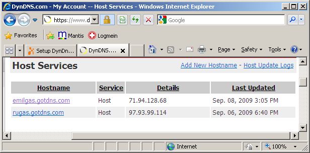

I have exactly like you have upthere, Except I changed the interval max and min to 7 0 0 0 for it to update at leaset once a week. Now how will my router know if the IP address changed? Usually it changes everytime you reload the router. Will the DynDNS method run everytime it has been reloaded.
Now I'm going to have to wait 7 days before I can actually see if it had been updated? Last time I set it to update every hour, and I got an abuse notification. LOL
The only confirmation I have is to look at the DynDns website directly to see when it actually got updated. (LOOK Below)
Every time your router gets a new dhcp lease it should send a dynamic dns update (and every seven days of course). Have you asked dyndns.org why your receiving the abuse message?
