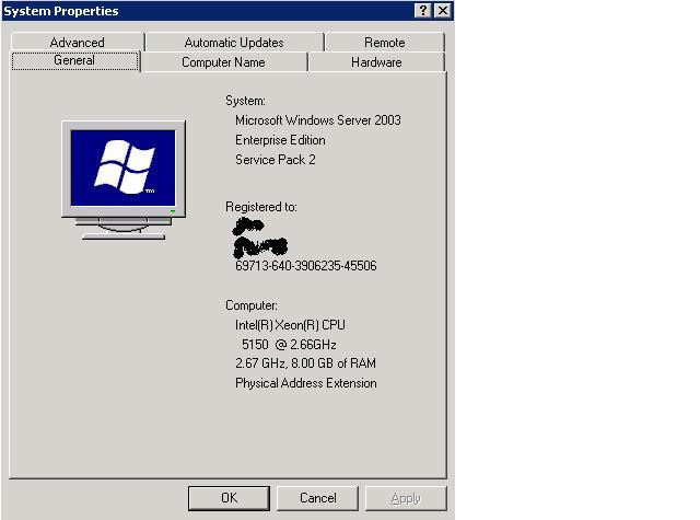

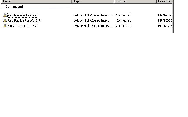

I upload the images with the server info, this server have teaming with one IP, and run  one application with IIS to run CGI and Authentication and back have tomcat with application. I talk with provider but he said the problem is with the users no have logoff and close the explorer, but i see the number os sessions never decrase.
Now have 215 LAST_ACK.
