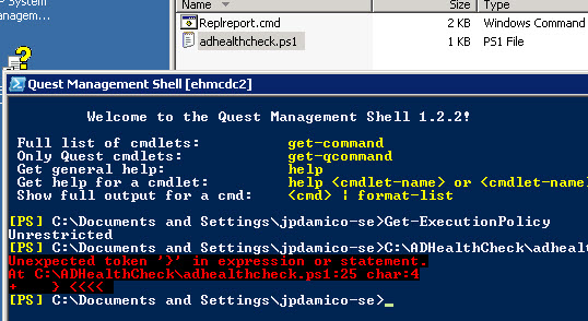

  How do I run it in powershell?
Avatar of nyceusernyceuser🇺🇸

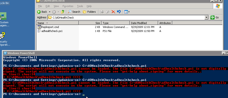

I get the following error when I try to run the script
Avatar of RickSheikhRickSheikh🇺🇸
That particular error can be solved by setting the execution policy to remoted signed.
Set-ExecutionPolicy -ExecutionPolicy remotesigned
However, I gave this script a try and it seems that the script is not given enough time to grab the txt files with results. It will need a modification.
Will take a look.

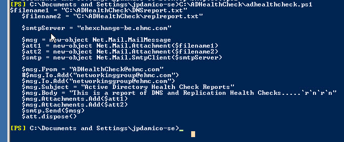

Thanks...i figured the execution policy out...now I get this error
Try adding a curly braces here :
   $filename1 = "C:\ADHealthCheck\DNSreport.txt"
   $filename2 = "C:\ADHealthCheck\replreport.txt"

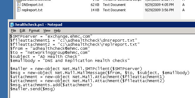

ok...almost there.  when I run the script....it's only sending the replreport.txt file...its not sending the dnsreport.txt.  any reason?
Excellent help
Emailing multiple files has its own trick I suppose. Haven't tried but this is what I found, feel free to test it out.
http://www.vistax64.com/powershell/176479-emailing-multiple-files.html
