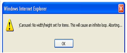

when i try to create multiple instances i get the error message attached as a image this is how i created two more instances
  {literal}
  jQuery(document).ready(function() {
   jQuery('#mycarousels').jcarousel({
  </script>
  {/literal}
    {literal}
   jQuery('#mycarouselss').jcarousel({
  </script>
  {/literal}

mattibutt
hi
i have tried that but it didn't work i don't know why now i have created two instances and it works i am just testing
i have changed the following codes
|loop|infinite|an|cause|will|This|items|set|No|jCarousel|alert|
to this
loop|infinite|an|cause|will|This|items|set|No|jCarousel|isNaN

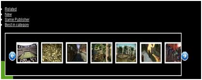

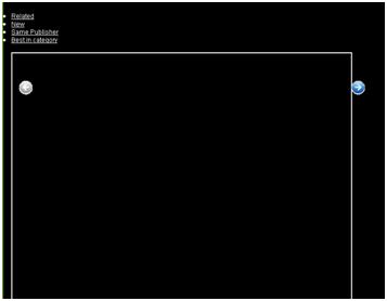

hi
as you can see from the attached images the first tab appears fine but the second tab appear quite weird and it doesnt show the thumbnails in that
there is another problem when page load for the first time all the hidden thumbnails are shown briefly like say for a second until javascript is executed
