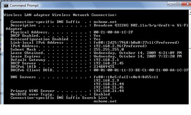

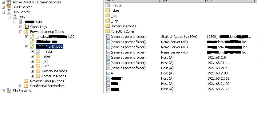

Darius Ghassem
Please post a screenshot of your DNS console with your zones. Also, post ipconfig /all
egalois
I may have inked over too much....    let me know and i will paste another version
Darius Ghassem
Did you post ipconfig /all for the server or a client? Please do the server as well and post.
First issue is that you have a DNS Suffix that doesn't match your domain called Mshome.net.
Disable IPv6 run ipconfig /flushdns, ipconfig /registerdns, and dcdiag /fix.
What is the second DNS zone listed?
There have been some problems with the msdcs zone being delegated. You need to manually update you SRV records in the msdcs.domain.com zone or you can delete both your domain.com and msdcs.domain.com zone and re-create it as one domain.com zone.
