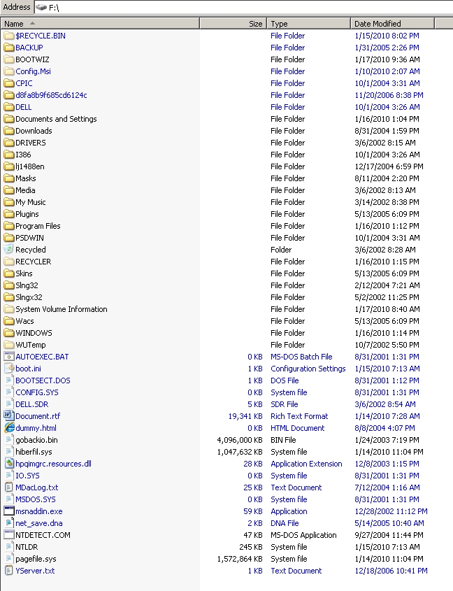

3) the root of the drive  ... looks normal

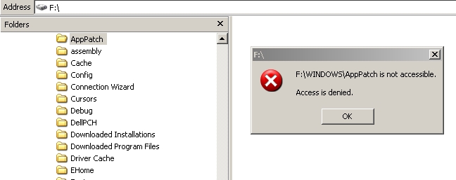

4) trying to open a folder inside of \Windows results in error.

   go to open ProgramFiles and Windows folders, explorer hangs, regedit too
   reboot ERD (it's so fragile, and slow to boot)
   (later discovered that some files in Windows and Program Files folders still had bad permissions.)
   lsasetupdomain owned the stuff.  (leftover from old domain membership maybe)
   booted into UBCD4win, reset ownership and access, and did

    Permissions still?  Let's brute-force it.
   reboot into ERD, reset all permissions on all files on C: to full access
   results in lots of attempts to access a token that does not exist
   Reboot ...  Viola!  We're in!   shut down, make a copy of partition,
