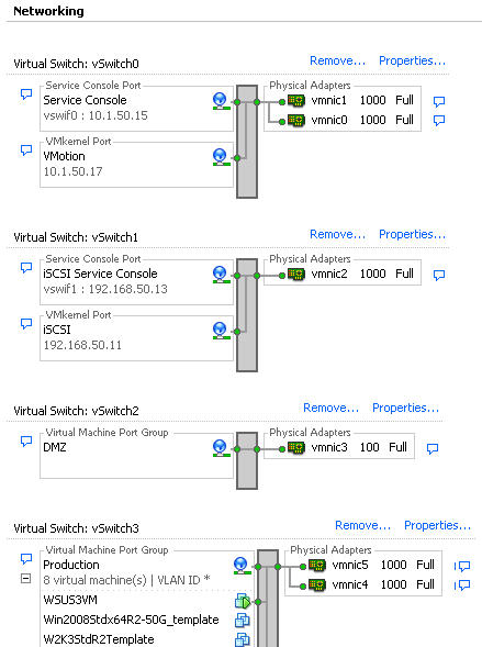

ESX 3.5 vmnic config requirements for network IP change
We have ESX servers that connect to our DMZ via a single physical nic. I am planning a project to change the network configuration of the DMZ, moving it from a public IP range to Nat'd private addresses. I need to know what needs to be done at the NIC/vmnic side of things to cope with the change in IP's.
The vmnic presently displays an 'observed IP range', but I am unable to track down any reference to a fixed IP on the appropriate NIC.
As I am unable to test this prior to cutover I'd like some sort of positive confirmation on what needs to be done for this to work

Can you screenshot you current network config or a draw a simple network diagram so that we can propose best design for you

My own suspicions agree with Paulsov  . Please review the attached image and confirm as appropriate.

So you want to move VMs to vSwitch2?

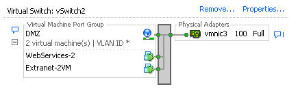

Nope - we have 2 VM's connected presently - I'm unsure why they did not show in the original image.
These VM's will be re-ip'd to the new network IP range, along with other physical hardware on the DMZ.
Is there any config that needs to be done to vmnic3?
Apologies, original image was from a host with no DMZ VM's attached.
