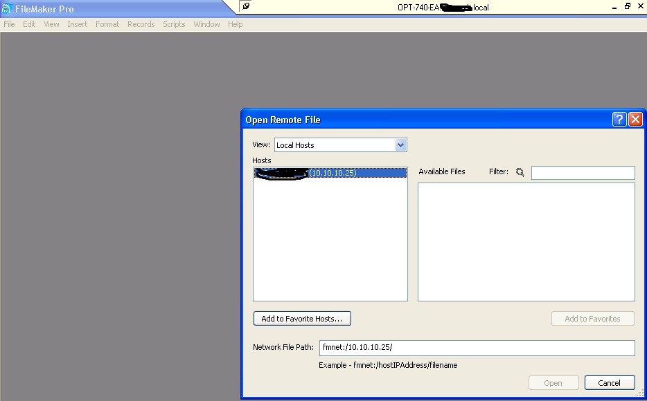

On the client (all Windows XP) with Filemaker 9.0.3 Pro, if I click File -> Open remote, I see the server and its IP address in the left hand pane, but where I used to see the databases/files to open - there is nothing.  Not even the sample file - which I think used to be there.  I have brought down the files to the local workstation and opened them to check the file sharing - and it is indeed on.  I have even turned it off - closed - reopened - turned on sharing again and closed again and then re-uploaded/added the databases to the FM server.  I have also tried using Filemaker Pro 10 as the client - same result.  I can see the server, but I can't see the databases on the server.

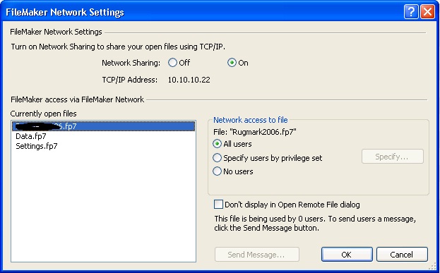

Go to Server admin, Stop the database that is giving you the problem. Open the same database from a filemaker client application, go to File=>Sharing=>Filemaker Network and select it to be visible on the Filemaker network.
Start up the database and check to see if you can now see it remote.
It is not obvious but this is the problem

I'm not sure where you're seeing this.  Would that be in the same place where I enable sharing?  If you look at my second attached image (see above), I included a screen shot of me enabling sharing when opening the databases locally from a client.  I see a checkbox there to make the databases **not** visible, but I don't see what you are referencing - unless that is what you're talking about - which is already set correctly (box unchecked).

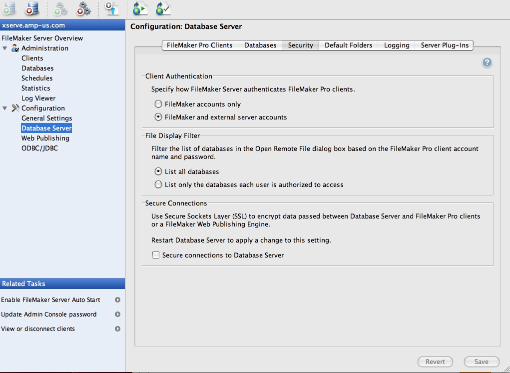

On the file server do you have the Configuration=>Database Server=>File Display Filter set to all files otherwise it will look at windows groups if you use domain authentication to decide what files to list.
Avatar of jvaldesjvaldes🇺🇸
see pic

on the server, I am set to "list all databases" - it's the default setting, and I'm set that way.

has the IP address of my server changed?  Yes is the answer to that.  Originally, when it was Server 9 on Windows 2003, it was at 10.10.10.2.  Then I installed Windows 2008 with FMS 10 at 10.10.10.3.  FMP can see the server, but not the databases on 10.10.10.3.
Then I installed FMS 10 on another 2008 server 10.10.10.25.  Same issue - can see the server but not the databases on the server.  You can see that in my third screen shot from my original question.
