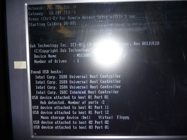

I'm trying to install ESXi onto a Dell 2950 server. I have downloaded the dell specific installer called "VMware-VMvisor-InstallerCD-4.0_Update1-208167.i386_DellCustomized.iso" which was downloaded from the dell site. I checked the MD5 hash value of the file which was correct and burnt it to new bootable CD.
I have done this several times with various different CD burners and programs.
In all cases the install stops in the same place - a picture is attached.
What is puzzeling is that I have an old 3.5 install disk - and it installs fine.
Anyone have any ideas why ESXi 4.1 refuses to install?

Unplug any USB devices you have  as that is probably what's causing it to hang.

Thanks - no external USB devices are plugged in. just the power supplies and the video display. I have even taken out the keyboard connector.
Any other ideas?

Without the ESXi CD in, does the server boot?
Will it boot with another CD in?
You need to try and establish whether the fault is with the ESXi CD or the server/CD-ROM.

VMware ESXi 4.0 requires Intel VT/AMD-V to be enabled on the BIOS since it runs a 64-Bit Kernel.
Please check whether you have enabled the same in the BIOS.
