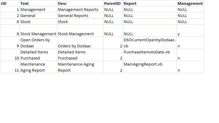

I am trying to implement a treeview (using telerik controls) and am running into an error.
"This constraint cannot be enabled as not all values have corresponding parent values." Attached is a snap shot of my table which holds information for the treeview. Does the structure need to change?  Any help would be greatly appreciated

I was able to get the treeview to half way work.... If I remove the ParentID it displays my reports in a list....
It does not like the ParentID for some reason.... ?

Been a while since I worked with Telerik treeview control, but what if you specify ParentID = 0 instead of NULL? I believe I have a telerik treeview in one of our customer apps, I can check when I return to work on Monday.

I would be grateful if you were able to check this out Monday. I tried to use ParentID = 0 and received the same error as above.

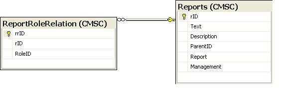

I did play with the relations and end up getting the same error. I know sql but I am not an expert. I have attached the table diagram and the sql I am using to get my report list. Please review
SELECT CMSC.Reports.Text, CMSC.Reports.Description, CMSC.Reports.Report, CMSC.Reports.ParentID, CMSC.ReportRoleRelation.rID FROM CMSC.Reports INNER JOIN CMSC.ReportRoleRelation ON CMSC.ReportRoleRelation.rID = CMSC.Reports.rID WHERE (CMSC.ReportRoleRelation.RoleID = @param)
