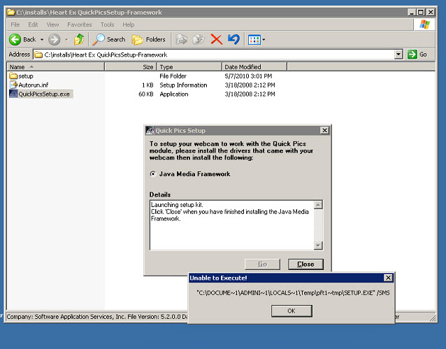

Weird problem when running a well known good program (Java MetaFrame) on a copletly Xindows XP SP3 with all MS Updates.  (see image).  This is what I have done:
1. Update Windows with all latest updates, etc.
2. PC is a DELL 2.99GHZ with 2GB RAM, working OK with all other programs
3. Downloaded a few times the original EXE directly from Java on different directories, and installing the EXE and it was giving consistant errors --> Unable to execute ... (like it could not create files in the temp directory for the user profile)

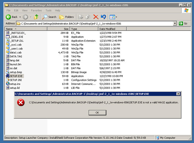

4. So, I decided to Uncompress the EXE unto my Desktop and run the Setup.exe manually, then I started getting --> SETUP.EXE is not a valid Win32 application.
5. Also, I spent two hours on the Internet searching for answers on this, found many people having the problem, but solutions like editing the registry ... did not help either.
6. All these was performed as an Administrator to the box, will full rights.
7. I  have seen this problem before here at my location, and I ended up reinstalling XP from CD in order to be able of installing the setup.exe succesfully.
8. The answer to this question may favor someone here in the future.
9. Attached are two images when running the application compressed and uncompressed.

John,  Just renamed to setup22.exe and gives same result --> not valid win32 ..  I am running malwarebytes right now just in case.  will let you know.
Avatar of Aaron ThornAaron Thorn🇺🇸
No viruses, nor malware.  Also, I just installed it on another identical computer and installs fine.  Weird!  I am still curious, what is causing the error.

Done: cleaned temp with ccleaner and shell:cache ..., reinstalled teh new WinInstaller, checked for malware ... still the same ... is got to be something easy ... but ???? can figure yet.  As a plan B, I am preparing another Box (XP) for my user, but I would love to find out the answer for this nightmare ... I have seen this problem at least 3-4 times, out of 120 PC's we have here.  Most of our PC's are cloned/imaged and we change the SID after all that ... new name, new IP, etc.  very weird.  Thanks to you all ...

Avatar of Vadim RappVadim Rapp🇺🇸
Avatar of jmcmunnjmcmunn🇺🇸
That's funny, and likely the cause....although ntvdm should allow a 16-bit install to run just fine in Windows XP.  Also, the author says it works fine on other similar machines.
The page where this file is found, http://java.sun.com/javase/technologies/desktop/media/jmf/index.jsp , mentions  Java Media Framework , not Java Metaframe. I'm totally unfamiliar with Java, but it does look like some confusion. I actually downloaded this package and tried to run in XP x32, and it said that win-16 subsystem does not have sufficient resources.  Try it yourself, it's on the above page.
