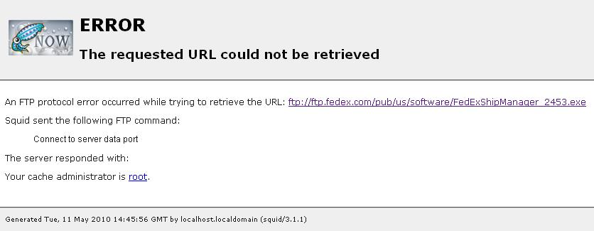

I have 4 servers running squid/3.1.1 proxy server. Since the latest version I can no longer FTP. I have posted this problem in multiple places but have received almost no response. I've found several other post to this problem throughout the Internet which have also gone unanswered. So, once again I thought I'd give it a try.
As I said "I have 4 servers running the newest version of Squid". When I try to access an ftp, any ftp, I receive an error (check attached image). This was never a problem until just recently. Squid should work perfectly fine with ftp, it is not a strictly http proxy.
I turned my firewall off just to make sure, still had the same issue. If I jump directly on the server itself with no proxy settings set in the browser it will work fine. As soon as I set the browser setting to access the Squid software I get the same error.
I've included my squid config (which is unchanged from the default settings), maybe somebody better versed than myself can point out an obvious flaw. Everything else seems to work just fine, it's only FTP that's a problem.

Also, if I go look at the /var/log/squid/access.log file I see the following message:
1273527600.117     51 172.17.137.11 TCP_REFRESH_UNMODIFIED/304 382 GET http://www.squid-cache.org/Artwork/SN.png - DIRECT/209.169.10.131 -

1273604907.384    382 172.17.137.105 TCP_MISS/502 4089 GET ftp://ftp.fedex.com/pub/us/software/FedExShipManager_2453.exe:21 - DIRECT/199.81.203.40 text/html
I'm getting the same line as I posted above in access.log when I try to access a ftp site. There is no doubt that the machines are talking to Squid. Squid just keeps rejecting ftp requests for some reason.

My error is different now since I disable SELinux however:
The following error was encountered while trying to retrieve the URL: ftp://ftp.fedex.com/pub/us/software/
Read Timeout
The system returned: [No Error]
A Timeout occurred while waiting to read data from the network. The network or server may be down or congested. Please retry your request.
Your cache administrator is root.
My guess is that the squid mirror link above uses some http front end and the the ftp links that are not working are talking directly to an ftp server because they just through up the standard "tree view" in the browser.
The squid mirror link had some icons and other eye-candy when I pulled it up. I don't think it's purely FTP, just a guess however.
