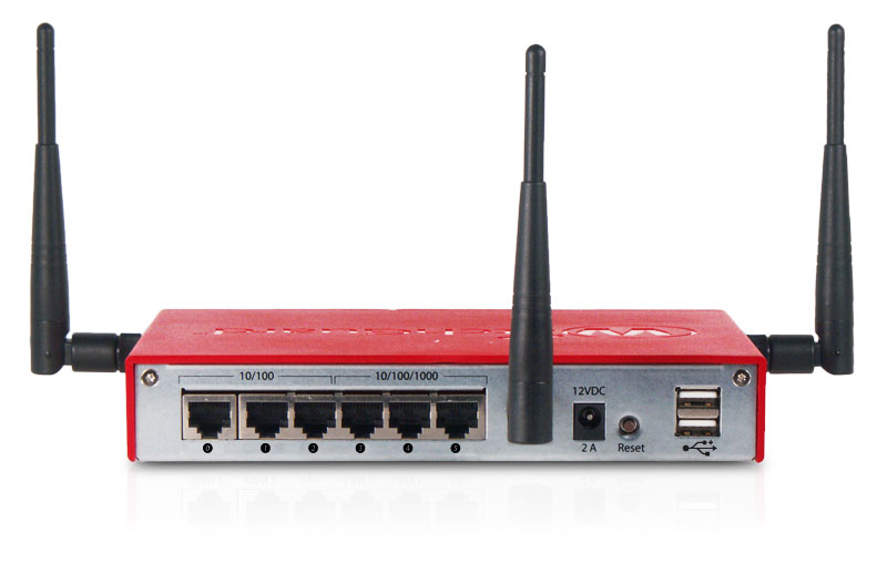

Ok what port do you have the main cable (From the SMC router to the XTM) plugged into when looking at the image below.
Avatar of Ray DrummondRay Drummond🇺🇸
The main cable is plugged into the first port on the left.  My laptop is plugged into the port next to that and the WAP is in the port next to that.

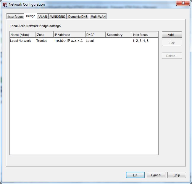

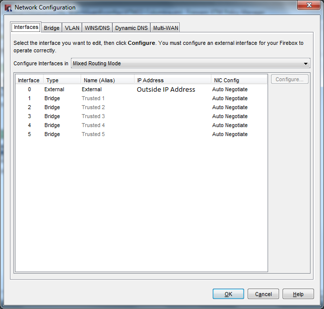

I ran into the same issue & found if you want to use Ports 1-5 on a single Local "Trusted" Network you must put all the ports into a bridge. The easiest way to do this is to use the Watchguard System Manager & not the web Interface. Using the System Manager under Tools - Policy Manger - Under the Network Menu - Configuration. Set the trusted interface to an ip outside of the internal network you want to use. Go under the bridge tab & create a new bridge with the correct internal "Trusted" network information including DHCP server info. Change all internal ports (1-5) to bridge and select the newly configured bridge for each interface. Save to the firebox and your finished User generated imageBridge.png
