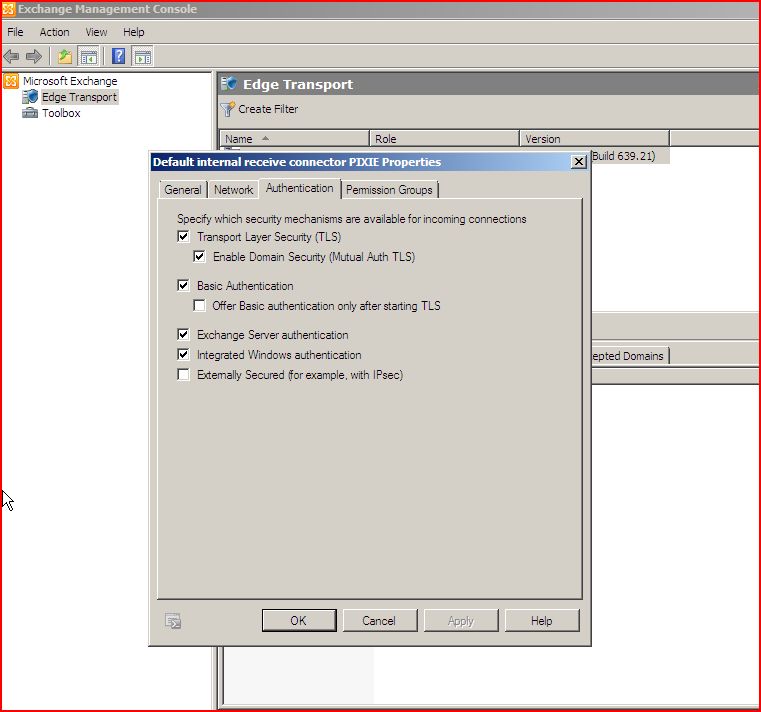

no prob, the issue is a check box you should do on the edge server.
open EMC on your edge and find your receive connector, go to the second tab and send me a screenshot i shld be able to help
Avatar of 5934159341
I think this is what you want
Avatar of AkhaterAkhater🇱🇧
nop actually I want to next tab the "authentication" one
sorry working from memory ATM
k, here ya go.

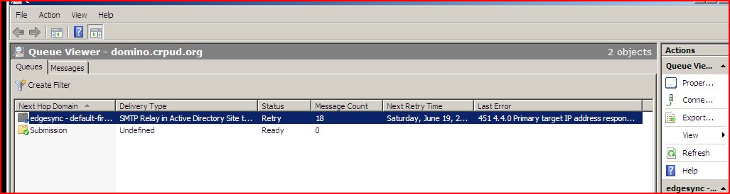

that is correct ! Can you share a screen shot of the queues on your HUB server"?
here it is. (I see some sort of error there, not clue how to get details)
If I hover over it it says 421 4.3.2 service not available

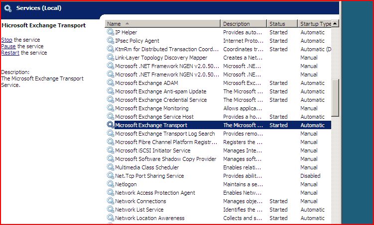

and the transport service on your edge server is started ?
transport is started, but net.tcp is not, should it not be started?

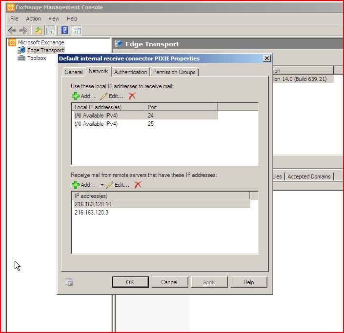

oh wait wait in your first screen shot, the 2 IPS listed below what are they ? is your hub server any of them ?
No, they belong to an outside spam filter service we subscribe to. Our MX records point to them, and they forward scrubbed mail to our smtp service.
I just added the hub server to the list, pretty sure it should be there. But no mail flowing still.

go to your queue and right click retry
still same error ?
No, now is different
421 4.2.2 Connection dropped due to socket error attempted failover to alternate host but that did not succeed

I remember that net.tcp port sharing service from the docs, is it risky to turn it on?
wish there was a way to see the error msg on the queue
451 4.4.0 Primary target ip address responded with "421 4.2.2 Connection dropped due to socket error..

both net.tcp services shld be started

I started the net.tcp service up on the edge server. It was already set to start auto on the hub server. I restarted the transport services. Retry on the hub queue still gets the 4.2.2 connection dropped due to socket error

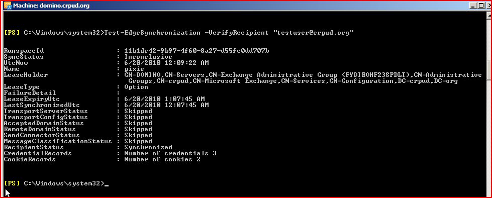

on your hub if you issue a Start-EdgeSynchronization -Server HubName
errors?
result success

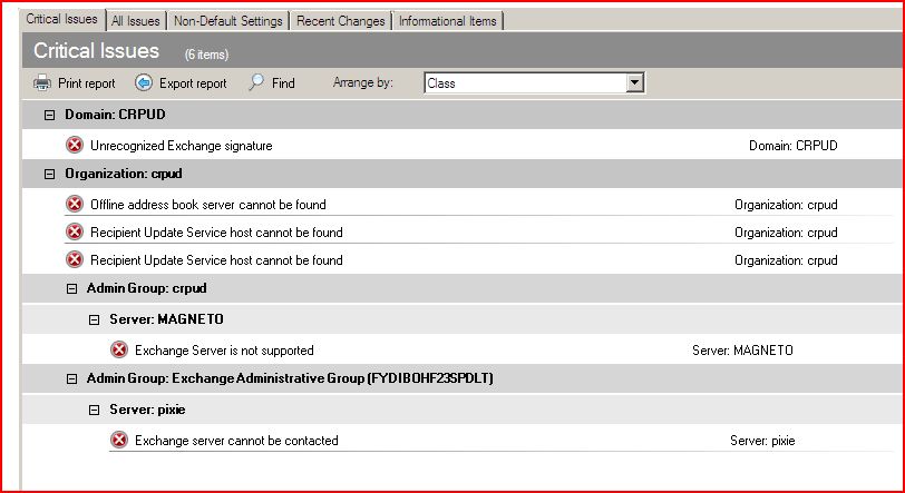

OK Time to run EXBPA
any special options?
try with a general heatlhcheck
I guessed the connectivity one and ran that. Red x on edge server, says Registry cannot be accessed.
health check looks like this :(
The OAB is an issue but not to be dealt with now
the exchange signature and the RUS nothing to worry about (unless you still have exchange 2003)
who are pixie and magneto ? Pixie is the edge right ?

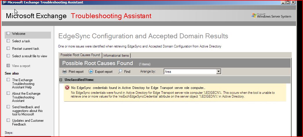

the trouble shooting assistant reports this, is it helpful?
yea sure it is helpful

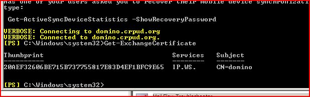

1. do you have port 50636 opened between your edge and your hub ?
2. what if you issue a Get-ExchangeCertificate on your hub server results ?

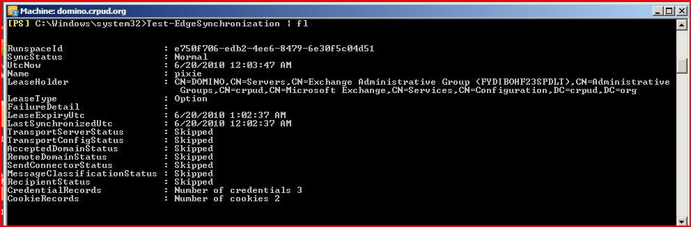

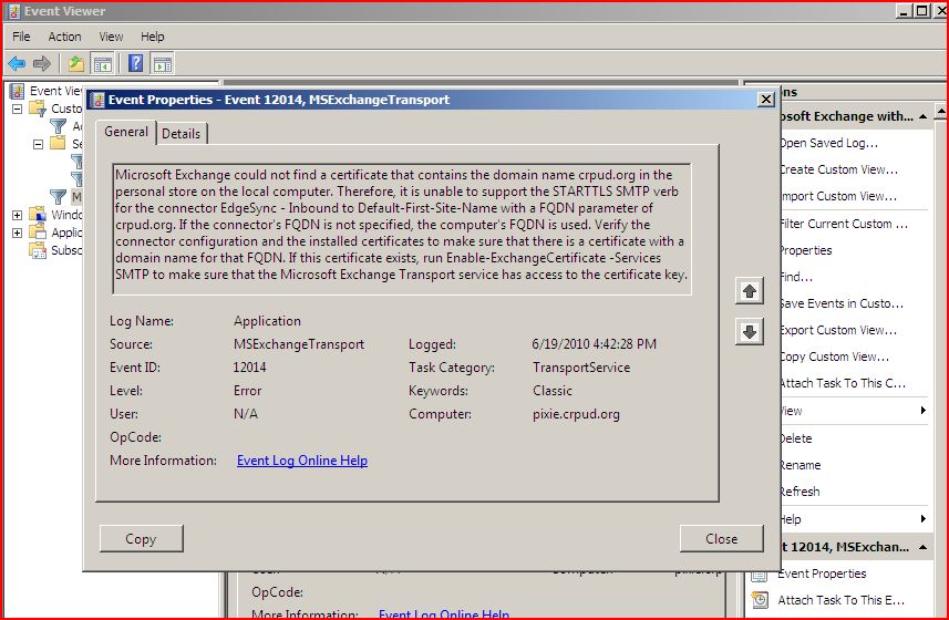

Edge server has some of these error in event log
Get-ExchangeCertificate on hub server looks like this
or more like this

test-EdgeSynchronization on the hub please
can do.
Not much interesting in the event logs on hub server
several skipped?

what about
Test-EdgeSynchronization -VerifyRecipient user@yourdaomin.com
"inconclusive"
(are the screen shots good or bad form?)
this "inconclusive" I've been finding on all 2010 edge test sync I'm starting to consider it as "normal" wasn't the case in 2007 but since the recipient status is sync i wouldn't worry about it
