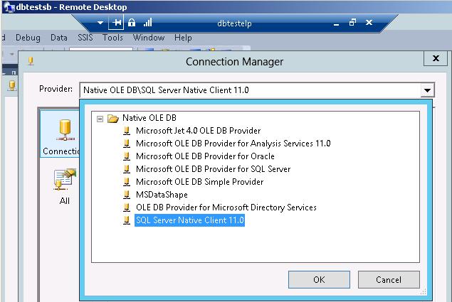

SQL Server 2012 Enterprise Edition (64-bit) edition on top of Windows Server 2012 Standard edition 64-bit OS
The SSIS Designer of above needs to connect to Oracle database and when I try to connect througth connection manager properties, the 'Oracle Provider for OLEDB' does not show up as mentioned in the attached screenshot.
I have installed both Oracle Database 11g Release 2 Client (11.2.0.1.0) for Microsoft Windows (x64) bit & 32 bit from the below urls.
http://www.oracle.com/technetwork/database/enterprise-edition/downloads/112010-win32soft-098987.html
http://www.oracle.com/technetwork/database/enterprise-edition/downloads/112010-win64soft-094461.html
I also follwed the below link to fix the issue, but still the 'oracle provider for oledb' is not showing up in the connection manager properties dialog box.
http://sqlblog.com/blogs/jorg_klein/archive/2011/06/09/ssis-connect-to-oracle-on-a-64-bit-machine.aspx
Please let me know how to fix this issue.
