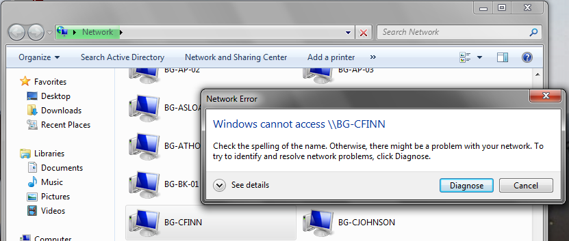

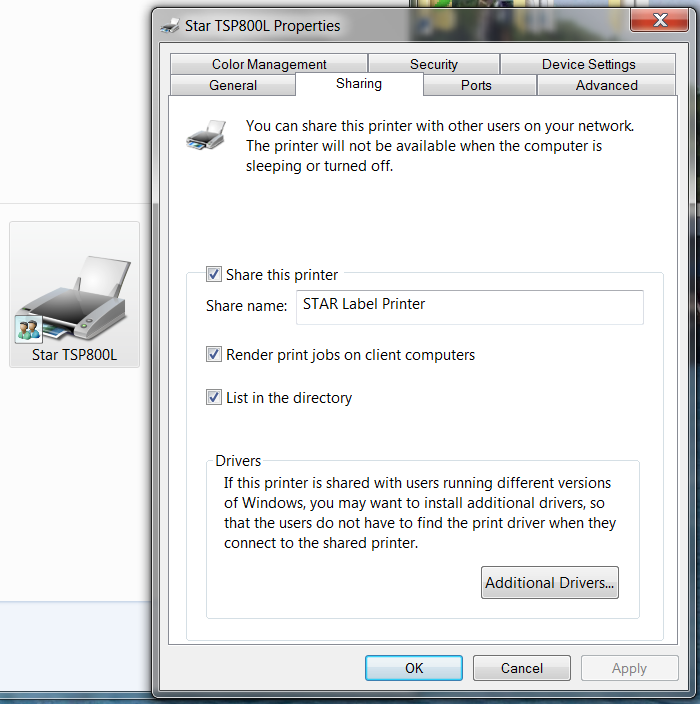

I am having problems setting up printer sharing on Windows 7 in my domain environment. I have been doing my troubleshooting/testing with two computers, both running Windows 7 Pro x86. There is a STAR label printer attached to BG-CFINN via USB. I have setup this printer as a shared printer and listed it in the directory. From BG-MFLOWERS when you try to add the shared printer you get the error message that "Windows couldn't connect to the printer. Check the printer name and try again. If this is a network printer, make sure that the printer is turned on, and that the printer address is correct."

Reinstall printer with the latest drivers

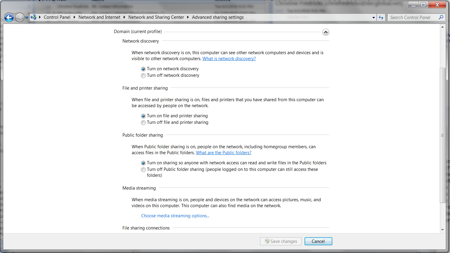

Checked that File and Printer Sharing were Enabled

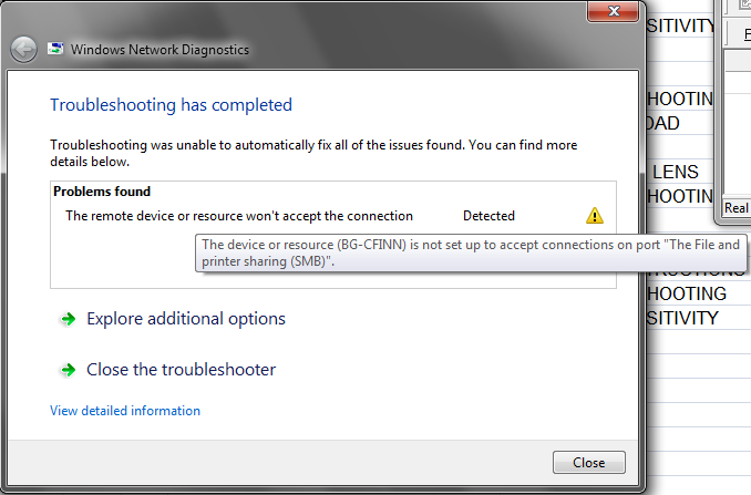

Created a standard file share on BG-CFinn, but could not connect to it either. When you run the connection diagnostics you get the following error: "The device or resource (BG-CFinn) is not set up to accept connections on port 'The File and printer sharing (SMB)'."

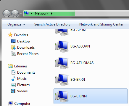

You can see BG-CFINN in both of their Network lists.

Do you have public printer sharing and printer sharing in general turned on in your network and sharing center?
Are there additional settings outside of Control Panel > Network and Internet > Network and Sharing Center > Advanced sharing settings?
I don't seem to see any settings in the Network and Sharing Center that specifically address Public Printer Sharing and Printer Sharing in general. Where do you find these? Can you post a screenshot?
