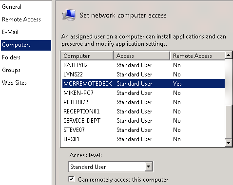

I ave in the SBS2008 console allowed each user as a standard user under computers for the ReoteDeskTop server (which is by the way a Windows 2008 Enterprise R2)

Go in to each user, click "computers" and give them remote access to the TS box you have, see if that helps.

The users are allowed access to the server (see picture)
