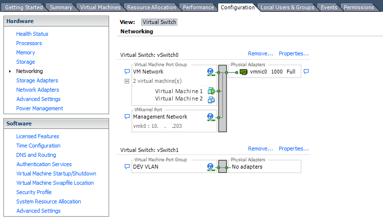

Where I work I want to create a virtual domain for testing purposes.  It will consist of a few servers & DC all hosted on an ESXi host.  So that this domain and it's machines are not visible to the rest of the network. I planned to put them on their own VLAN - but - still have a route or uplink to the production network for internet.
I could of course just place a physical router in between the ESXi box and the rest of the network, but that would be too easy. :)
I found in the vSphere Clinet (ESXi) where I can add a Virtual Switch. (Screenshot below)  I don't know enough about it, though, to create what I'm wanting to do in my above description.
Suggestions would be appreciated and any detail or steps would be helpful too.
Thanks! User generated image

What you could do is leave your current vswitch which has no uplinks the way it is and your test/dev vm's to it, but add on more vm that is running something like ISA server that has two uplinks.  So, in Edit Settings you would have network adapter #1 going to the "private" vswitch and network adapter #2 going to your VM Network portgroup.  Then configure your bridging/gateway vm to pass only certain traffic through.
