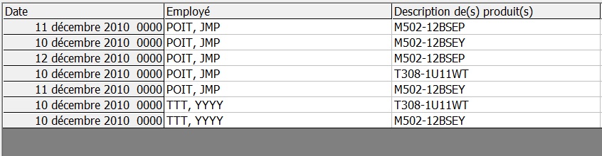

Avatar of Wilder1626Wilder1626🇨🇦
Hello robberbaron,
This is the result if a put format:
in this case you would need to truncate the date field to drop the time.   to test this, change the "dd mmmm yyyy hhnn" to be "
See picture 1.

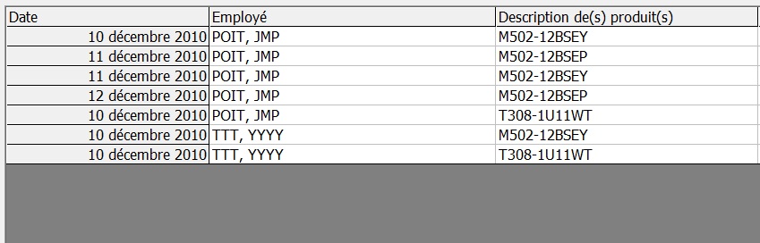

aikimark,
If i use format: yyyymmdd like you say, see the picture 2. It his worst.

  Dim sSQL2 As String
    Dim oRST2 As ADODB.Recordset
  Set oRST2 = New ADODB.Recordset
  Dim oConnect2 As ADODB.Connection
  Set oConnect2 = New ADODB.Connection
   oConnect2.Open "Provider=Microsoft.ACE.OLEDB.12.0;" & _
    "Data Source=" & Form4.txtBaseDe.Text
sSQL2 = "SELECT [Période],[Employé],[Description_du_produit],[Quantité_assignée_ajustée],[Montant_ajusté] FROM [Distribution_employé] Where " _
& "Période >= '" & ComDateDisponible.Text & "' and " _
 & "Période <= '" & ComDateDisponible2.Text & "'"
 sSQL2 = sSQL2 & " ORDER BY [Période]"
oRST2.Open sSQL2, oConnect2
If oRST2.BOF = False Then
Do Until oRST2.EOF
  MSFlexGrid1.AddItem Format(oRST2("Période"), "yyyymmdd") & vbTab & Trim(oRST2("Employé")) & vbTab & oRST2("Description_du_produit") & vbTab & oRST2("Quantité_assignée_ajustée") & vbTab & oRST2("Montant_ajusté") & vbTab
  oRST2.MoveNext
Loop
  With MSFlexGrid1
        .ColSel = 0
        .Sort = flexSortStringAscending
        .ColSel = 1
    End With
Else
   'no record found...do something here
End If
End If
With MSFlexGrid1
    If (.Rows > .FixedRows + 1) Then
        .RemoveItem .Row
    Else
        .Rows = .FixedRows
    End If
End With
'Total
For r = 1 To MSFlexGrid1.Rows - 1
  If Len(MSFlexGrid1.TextMatrix(r, 3)) Then Total = Total + 1
Next r
lblTotalrecord = CStr(Total)
cmdCommand1.Enabled = True
End Sub

Avatar of aikimarkaikimark🇺🇸
Try this.
Private Sub cmdRechercher_Click()
If ComDateDisponible <> "" Then
  MSFlexGrid1.Clear
  MSFlexGrid1.Rows = 2
  MSFlexGrid1.Cols = 5
  'Column name
  MSFlexGrid1.TextMatrix(0, 0) = "Date"
  MSFlexGrid1.TextMatrix(0, 1) = "Employé"
  MSFlexGrid1.TextMatrix(0, 2) = "Description de(s) produit(s)"
  MSFlexGrid1.TextMatrix(0, 3) = "Qté(s) réalisée(s)"
  MSFlexGrid1.TextMatrix(0, 4) = "Gain(s) réalisée(s)"
  'autofit column
  MSFlexGrid1.ColWidth(0) = 3400
  MSFlexGrid1.ColWidth(1) = 4800
  MSFlexGrid1.ColWidth(2) = 4400
  MSFlexGrid1.ColWidth(3) = 3100
  MSFlexGrid1.ColWidth(4) = 3100
  Dim sSQL2 As String
    & "Période >= #" & ComDateDisponible.Text & "# and " _
    & "Période <= #" & ComDateDisponible2.Text & "#"
    Do Until oRST2.EOF
      'Total non-empty descriptions
      If Len(oRST2("Description_du_produit")) <> 0 Then Total = Total + 1
      oRST2.MoveNext
    Loop
    With MSFlexGrid1
        .ColSel = 0     'minor key = date
        .ColSel = 1     'major key = employee
    End With
  Else
  End If
End If
With MSFlexGrid1
        .RemoveItem .Row
    Else
        .Rows = .FixedRows
    End If
End With
End Sub
if [Période] is a date column you should be able to eliminate your grid sorting by letting the database engine order the rows before you load the data into your grid.
 sSQL2 = sSQL2 & " ORDER BY [Employé], [Période]"
Hummm, that would be a big change, i think.
I will take a look if this is a major work to bring Periode has a date value.
I will let you know the result shortly.
1/ based upon your export CSV, it appears to be a type other than text.   the 10-d,c-10  is not a text represtentaion of a date and appears only partial ?
Nø;P‚riode;Employ‚;No_Bon;
183;10-d‚c-10;POIT JMP;789;
2/ What is your datasource ?  MDB, XLS ?   Please post the actual source string and file.
If i understand your question, my data source is Microsoft Access 2007 .mdb
does it answer your question?
I just want to make sure that i understand your question right.
apologies. just realised that 10-d,c-10 is a translation of 10-dec-10  where the e is the european character.   so could be either date or text field.
BUT MSDN quote"Remarks
The Sort property always sorts entire rows. To specify the range to be sorted, set the Row and RowSel properties. If Row and RowSel are the same, the MSHFlexGrid will sort all non-fixed rows.
The keys used for sorting are determined by the Col and ColSel properties. Sorting is always done in a left-to-right direction. For example, if Col =3 and ColSel =1, the sort is done according to the contents of columns 1, then 2, then 3."
So we have a problem using the flexgrid to sort.  So back to my comment #34359629, we need to sort as part of the query.
Adding an order by SQL clause (same as akimark), produced the desired result when I used an Excel file as the input source, and the Date column was a Date format.
sSQL2 = "SELECT [Période],[Employé],[Description_du_produit],[Quantité_assignée_ajustée],[Montant_ajusté] FROM [Distribution_employé] " _
        & "WHERE Période >= #" & ComDateDisponible_Text & "# " _
        & "AND Période <= #" & ComDateDisponible2_Text & "#" _
        & " ORDER BY [Employé], [Période];"
        Do Until oRST2.EOF
          oRST2.MoveNext
        Loop
        'With MSFlexGrid1
        '    '.ColSel = 0     'minor key = date
        '    .Sort = flexSortStringAscending
        '    .ColSel = 1     'major key = employee
        'End With
      Else
      End If
So i realy have to change it to a date format.
Right?
OK thanks. I will take a look at it right know and let you know of the result very shortly.
Thanks again to both of you for your help and patience.
Thanks for that test.  Well, the only way to sort this using the grid's sort method is to create a hidden column so that the (sorted) columns are in adjacent left-to-right position.  Since we were reformatting the date anyway, it seems logical that we create a hidden column for the date to the right of the Employee column.
I still think that doing the sort coming out of Access is the best way.
Right?
 Yes, if the data is a date then store it as one as it is more efficient on a number of levels.
Create a new date field in the Access table and run a transform on your current date-string field to fill the new field.
@robberbaron
Yes.  Letting the database sort the data is certainly better than flexgrid sorting.
Hello all,
Sorry for the delay. LOt of work on my code to be sble to fix this also.
Now they are both date field and it work very good.
