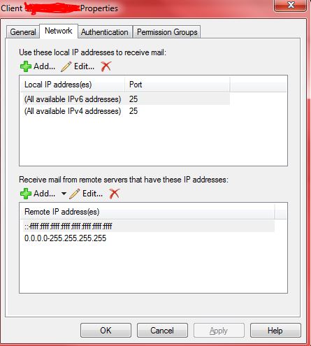

Avatar of didbadidba
In the default receive connector I enabled anounomus access.which except connection from anything. Please check the screenshot. User generated image
Hmm.
I hope this is a new connector.
This connector should have the Remote IP Addresses removed and only allow the ones in which you want to be able to relay via Exchange.
THis is not  the new connector. It is not  working with new connector - that was my main question.
This is the default connector which creates upon EX 07 setup.
