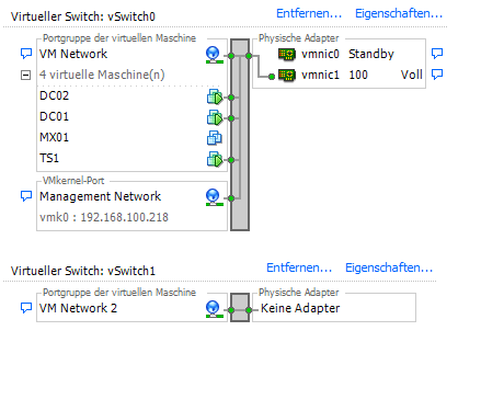

Hello
I want to change my VMware adapters speed from 100mb to 1000mb Full.
How can i do that?
Do i need to shutdown all vms?
How can i do that?
In the last question, Select the Network Adaptors Tab in the vSwitch and highlight the NIC and Click Edit, select the Network Speed for the NIC.
do i need to shutdown all running VMs?
There will be a moments outage as the Server re-connects to the switch at 1000MBps.
If you are running production machines in service, there may be a slight outage of a few seconds.
But no, you do not need to shutdown the VMs.
ok then i will do auto
thanks works i think
Glad I could help.
