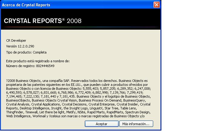

is
2008 version
im attach the banner
That is not CR8 but CR12.
I don't know if CR2008 works with VS2010.  It was my understanding that only the version developed for VS2010 would work.
