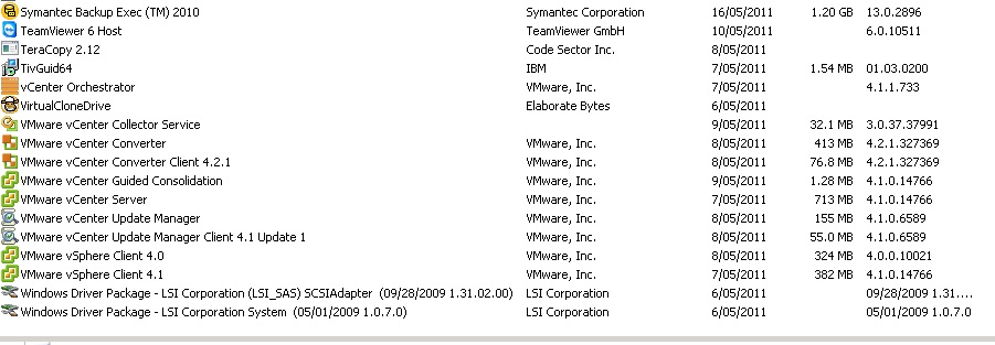

From the x3250M3 ( vCenter ) shows the LUN 29 ( same as it shows under ESXi ), the status is online and
heathly so I guess it fine too. However, I seems cannot backup anything by using SAN Transport Mode,
Backup Exec shows all vCenter and guest OS, I can tick them and everything sounds OK until I start the
backup job.
After the pre-processing of Backup Exec Job load, it returned Final error: 0xe0009585 - Unable to open a disk of the virtual machine.
I didn't set any special thing on the DS3512 and in fact I created a NTFS partition and I can have read / write access to it.
