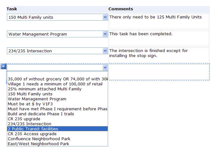

So... I'm trying to understand your goal and this is what I'm understanding:
Avatar of nsyyoung
nsyyoung
sorry, too fast with the clicker...
The d-d list in my Task column pulls from the sharepoint list; do you want the comments field to be put into a new list that can be filtered by the Task column, or do you want the entire form to be put into sharepoint, which you'd then have to preview to find particular comments?
