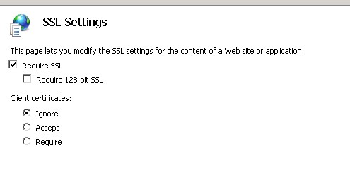

In IIS7 Manager, expand SERVER (DOMAIN\Username) > Sites > SBS Web Applications > and click on Rpc
Then click on "SSL Settings" in the Features panel
You will see the settings as pictured below.

I found RPC under Server > Sites > Default Web Site > RPC ( I don't have SBS Web Apps)
Clicking on the SSL Settings feature I see the same settings as you have specified.
I also see SSLwithCert.  Clicking on SSL Settings feature I see:
Require SSL - checked
Client certificates - Require
Sorry, the SBS Web Apps was for 2008...
Switch Client Certificates to "Ignore"
Then Restart IIS  (command prompt "iisreset")

They are the same,  Require SSL is checked and Client Certificates is set to Ignore.
