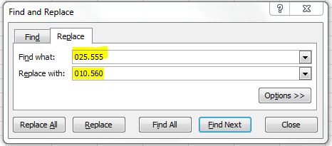

Did you tryed using Find and Replace (Ctrl+H) Excel's function for this?

these solutions dont work for hundreds of items i need to change, they only work for a single item, i need to copy and paste the formula, please adjust
