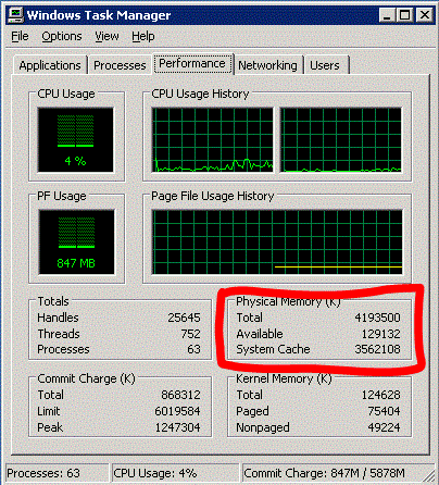

I'm running the script now, and FILESERVER1 is at 97% memory utilization.  One user got successfully moved and it's in the middle of the second one.
Attached is a screenshot of Task Manager of FILESERVER1.  The Available memory is down to 130 megs, and the server itself has a total of 4 gigs of RAM.  Under normal use, 3.0-3.5 gigs of RAM is usually available.
The second user is currently being backed up and he has a mailbox size of 1.2 Gigs.

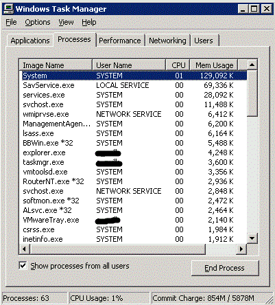

Can you look at the actual processes and sort on memory usage and determine which ones are the heavy hitters?
The interesting part is that the process doesn't show up in Task Manager.  3.5 Gigs of RAM is being used on FILESERVER1, but the top process with the highest memory usage is only 130 megs.
