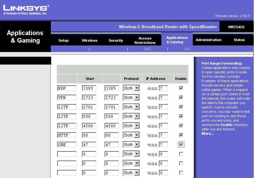

Tried turning off firewall in Vista, and enabling the pre-set firewall inbound rule on the router for GRE.  No luck.  I'm attaching screen shots.  I thought you might have meant having GRE as a port-forwarding setting, so I tried that also.  Still a "no go".  Thanks so much for helping me out!! Port Forwarding Settings on Router Windows Diagnosis on Vista Remote Client

I've emphasized the word protocol in conjunction with 47 - you defined port 47, a common misunderstanding. However, your Linksys should already manage that if you switch on PPTP/VPN passthru.

I've tried setting up L2TP as you can see in my screen shot posted earlier, but still can't get connected.  Am I missing a step, other than setting up those ports on my router's port-forwarding table?

All you should need to do is to forward L2TP (1701/udp). IPSec (500/udp and 4500/udp) should not be required to be forwarded, but it doesn't harm to do so.

Looking at my screen shot above, haven't I already done that?
cfwilbur
Here are my current port forwarding settings on my router:
 Router Settings
