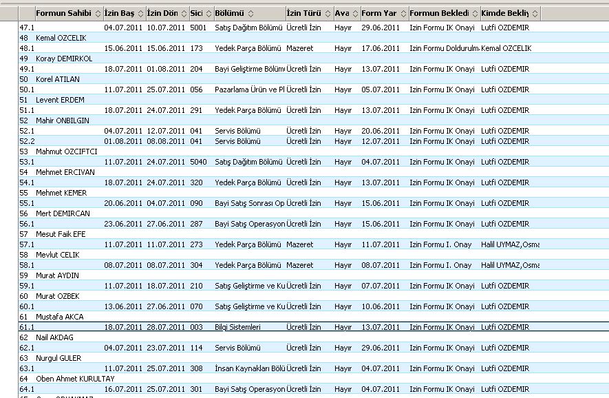

I want to obtain the columnvalues of a view how can I do that?
I use viewnavigator and obtain the entry but I need to get the column values of the entry.
How can I do this?
ColumnValues are calculated using formula ,so I guess it is not possible to obtain values with viewNavigator?
Doing that what I want to achieve is that, I need to get the two dates on the form and name of the creater of the form and then compare it to other forms' date and name information,if the person is the same and it has collapsing dates I need to change the color of both records of view so that someone can easily find the problamatic,collapsing records in the view....If I was able to retrieve the information of the records easily with viewNavigator .I was going to do that but I dont know what can be done on this? User generated image
'Below is the code I dont know is there a way to obtaing the column values which there are about 13 columns in the view??
