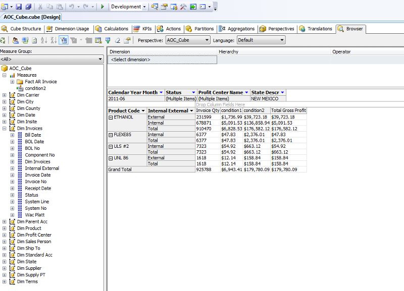

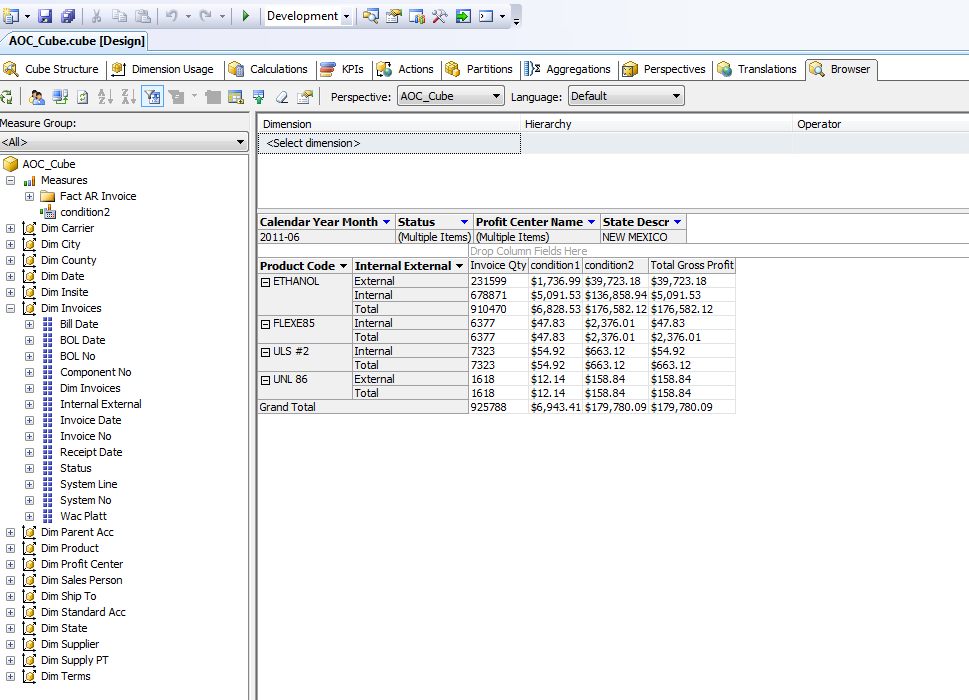

I think this code is very close to the solution but still i have problem with the Total .
I sent u attached pic, did you c the total for the gross profit? its not correct. for example
the Ethanol product, we have External Gallon 231599 and internal Gallon 678871 Total Gallon is 910470 if you c the gross profit
it should be
External
$39,723.18
 Internal
$5,091.53
Totalshould be $44,814.71 NOT $176,582.12
 User generated image User generated image
Sorry, I can't relate the image you've posted to the calculation.
In your grid I would have expected to see a column for 'Gross Profit Internal' and a column for Gross Profit External. And I wouldn't have expected the Internal / External dimension as you said you didn't want to include that in the query.
What are 'Condition1' and 'Condition2'?

Total Gross Profit:
IIF([Dim Invoices].[Internal External].currentmember Is [Dim Invoices].[Internal External].&[Internal],[Measures].[Invoice Qty] * 0.0075,([Measures].[Total Revenue] - [Measures].[COGS]
 + [Measures].[Supplier Discount] +[Measures].[Total BLND Credit] + [Measures].[Supplier Rebates] + [Measures].[TVA] - [Measures].[Marathon Promotional Fund Fee]))
I add the internal and the external to make it clear, but in the production i will not show it i will show the total only but as you c the total is not right.
Well you're not using the code I posted for [Measures].[Gross Profit Internal] and [Measures].[Gross Profit External] - why don't you try this?
What you're doing will not work because your calculations are based on a currentmember value for the internal / External dimension. There is no value for this in the overall total line - it will sum across all dimension members.
Tim
