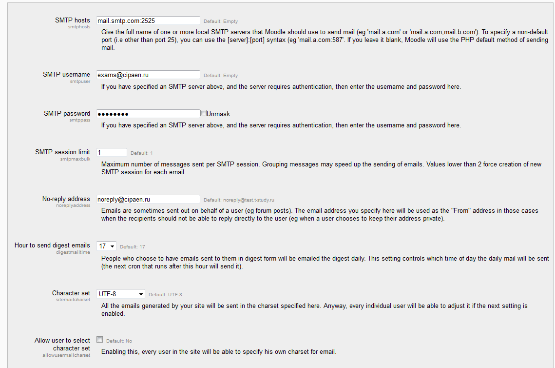

I am trying to configure Moodle to send out email using external provider SMTP.COM.
So, I set the settings, see a pic attached. But it returns an error "SMTP Error: Could not connect to SMTP host." and does not sent any mail out.  Why is that? How to fix it?

Change your smtp host to simple "smtp.com", not "mail.smtp.com".

1. The SMTP works fine within outlook e.g., so it could not be smtp.com problem. I think it is Moodle somehow.
2. WWW.SMTP.com is a mailing provider I use to send reliable and mass mail as Moodle could not sent more the 50 mails per section.
3. I tried all the ports you have mentioned but the result is the same.

Well,  Moodle Email settings says the following:
Currently, the parameter check is too strict to allow this via the Moodle UI; however, MDL-15923 has been created and resolved to address this. Until then, it can be set via phpMyAdmin using a query statement like:
 UPDATE mdl_config SET value='myemailserver.com:587' WHERE name='smtphosts';
Secure SMTP hosts with SSL/TLS
For SMTP hosts that require secure authentication, SSL or TLS you must run the following query:
 UPDATE mdl_config SET value='ssl://myemailserver.com:465' WHERE name='smtphosts';
Avatar of Frosty555Frosty555🇨🇦
Are you hosting your own moodle on a local server? Or a web host? Or some kind of hosted moodle platform?
From the link that paul posted, it looks like Moodle sort "sortof" supports specifying a port for the smtp server, requiring a patch to make it work... try just using "smtp.com" instead of "smtp.com:2525", so that it uses the default port 25 for sending email and see if that works.
Also you need to doublecheck that SSL is *not* being used - look in the database using phpmyadmin if necessary. If that SSL parameter that paul posted has been set in Moodle then it won't work, since smtp.com does not support SSL.
