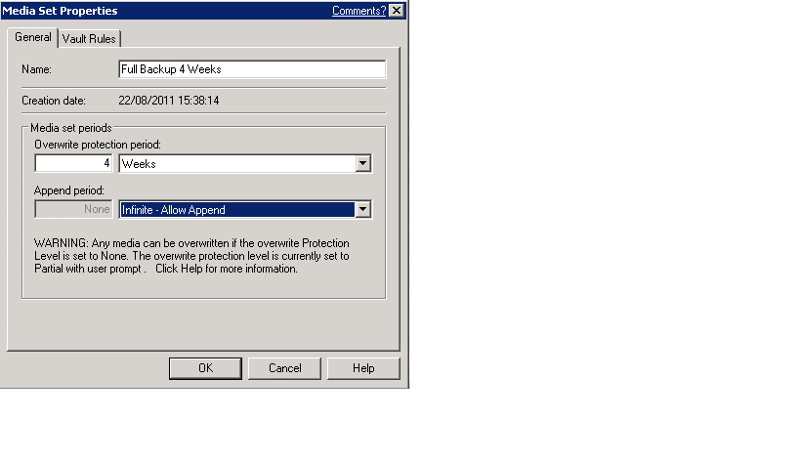

My question is media related.
Imaging I have 4 Jobs running daily, they backup to local disk then duplicate to tape.
I am confused a little with myself.
Job 1 Disk-2-Disk (Media Set 1Hour)
Job 2 Duplicate Disk-2-Tape (Media Set 4 Week)
Job 3 Disk-2-Disk (Media Set 1Hour)
Job 4 Duplicate Disk-2-Tape (Media Set 4 Week)
My question is once Job 2 has finished backing up to tape the tape becomes Overwrite Protection for 4 weeks.
When job 3 is complete job 4 will not be able to overwrite the tape but will be able to apend it.
Media Set Prop
So at the end of the days backup I will have the two jobs on there and they will be protected for 4 weeks?

BarcaConnect With a Mentor Commented:
Yes, when job 2 complete the tape media will protect (4 weeks), you need change the tape when job 2 complete.
denbosseConnect With a Mentor Commented:
Bransby-IT, Yes - at the end of the day you will you will have the 2 jobs on the tape and they will be protected 4 weeks from the minute the last bytes was written by Job 3.
You don't have to change the tape after job 2 completes as Barca suggest. Just make sure that job 4 is defined with the option "Append, overwrite if no appendable media is available".
Job 2 should be defined as "Overwrite". (so no append for that job).
One remark: you have a 1 hour protection for job 1 and 3. Just make sure that Job 1 or 3 don't take longer than 1 hour in total if you want to do that. Also, make sure job 2 completes before job 3 kicks in. Otherwise depending on the time job 3 starts, it could overwrite job1's data, while job 2 hasn't finished writing it to tape.

Sorry - in my first comment I meant "... they will be protected 4 weeks from the minute the last bytes was written by Job 4
