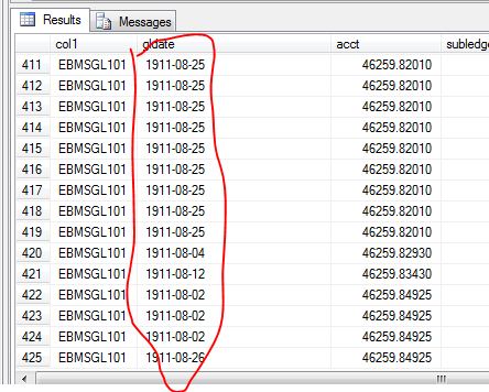

Ok it ran but my dates are all in 1900s.
Avatar of vdr1620vdr1620🇺🇸
Avatar of rochestermnrochestermn🇺🇸
How do I change the dateformat to short date in this format:  10/3/2011?
Thanks again.
It is in a short date Format .. you cannot really mention the format of the date Type Field, I mean SQL treats all the dates as in one single date format .. my sentence might really not make sense but what I mean can be illustrated by an example below...Run this script in your SQL browser Window and see the output results for yourself..
you can the run the package as is ..and sql wll make the changes... Now, if the data type is not Date then we will need to change that in the Derived Transformation by replacing "-" with "/" and interchange the date format to DD/MM/YYYY

Im having difficulty getting this date in the format mm-dd-yyyy.  The fomula below puts it in yyyy-mm-dd
Can someone help?
(DT_STR,20,1252)(SUBSTRING((DT_STR,10,1252)Jdate,1,1) == "1" ? "20" : "19") + SUBSTRING((DT_STR,10,1252)Jdate,2,2) + "-01-01"
